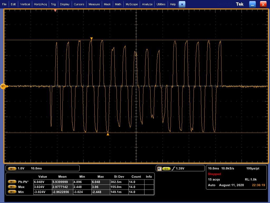

Hi
We set overdrive voltage = 3Vpeak as attached excel
But we find when we change DRV2625 VDD voltage, the waveform Vp/Vpp also change as below table
Is it normal? Since as I know the Vp should limit at Vpeak setting
Thank you~~
Haptic_VDD(V) Waveform Vp(V) Waveform Vpp(V)
4.4 3.42 6.84
4.2 3.34 6.68
4 3.3 6.6
3.8 3.22 6.48
3.6 3.14 6.32
3.5 3.1 6.2
3.4 3.06 6.12

  • Hey Poki
    I think your problem might be due to the fact that you are too zoomed into you oscilloscope and are picking up a lot of the PWM noise which is the all fuzziness at the peaks of the wave forms. If you zoomed out and then took measurement of the peaks it may give more consistent result that at your OC_CLAMP voltage.
    So measured with a large time division and show and examine those results
    Also are you making sure to either auto-calibrate or reload in the calibration value settings from the host processor every time you turn on and off when you change VDD.
    Carson

  • What I am saying is when you have it zoomed in like you do you see ripple from PWM which will make the waveform look like it is going above my clamp voltage of 3V.
    Where as if you zoom out on this same waveform that switching frequency is not picked up and see that the waveform is not going past 3V like this:
  • So when trying to calculate Vrms and Vpeak try to freeze it at a large time scale and zoom in so the PWM is not being picked up and it looks like this:
    Try doing that and see if you get it to obey your clamp voltage setting even when you vary the VDD.
  • Hi Carson:
    We decrease sampling rate to 5K/S and find the PWM noise disappear
    Our setting is rated voltage = 1.8V, clamp voltage = 3V
    We change VDD 3.6V and 4.4V and the Vpp still change as below chart(VDD=3.6V, Vpp=6.192V; VDD=4.4V, Vpp=6.84V)
    What is your VDD setting in the previous test you provide?
    And please help change VDD=3.6V and 4.4V on you side to see Vpp status
    And if your test, Vpp won't change with VDD, which setting or anything we need check? Did you check our setting file(excel)?
    Thank you~~

  • So I did the same test as you with clamp voltage at 2.82
    Vdd = 4.4  Vpeak = 2.68
    Vdd = 4.2 Vpeak = 2.68
    Vdd = 4.0  Vpeak = 2.66
    Vdd = 3.8  Vpeak = 2.65
    Vdd = 3.6  Vpeak = 2.63
    Vdd = 3.4  Vpeak = 2.63
    So unlike yours, my Vpeak doesnt change drastically with Vdd but still does a little and it also does not surpass the clamp voltage of 2.82.
    Let me ask you a few questions:
    1. So, are you making sure to run auto-calibration everytime the power supply is changed? You should probably not load in old settings from a different power supply
    2. Is this happening across consistently across chips or all your readings from a single PCB?
    3. Are you making sure what ever you are writing to the OD_CLAMP register is what you think you are putting it? I would read the reigster to make sure
    4. I also noticed from past photos you are measuring off cardboard, are you still doing that because the material can add more noise to readings?
    5. Are these measurements with or without an LRA attached or with the appropriate output filter for recording?
    Answering those will help get to the source of the problem here
    Carson

    But the result is the same, Vpp will change with VDD, and Vpp(Vp) over setting clamping voltage
    you can check below chart
    Rated voltage=1.8V, clamping voltage=3V, VDD=3.6V/4.4V
    Rated voltage=1.8V, VDD=4.4V,  clamping voltage=3V/4V
    What the reason you use 20s/div to measure?
    And could you provide your test waveforms for us?
    Because I want to check what the Vpeak you measure
    Thank you~~

  • Hi Luis:
    Yes I change the VDD level and then configure the device
    The result is the same
    I do open loop but get the same result as below chart
    And could you help provide your test waveforms for us?
    Thank you~~
    VDD=3.6V, Vpp=6.44V
    VDD=4.4V, Vpp=6.68V

  • Hi, Poki,
    One question regarding your captures, do you measure the output through output filters like the one mentioned in section 5 of this document?
    https://www.ti.com/lit/ug/slou432a/slou432a.pdf#page=10
    Luis Fernando Rodríguez S.
  • Hi Luis:
    Yes we measure the output through output filters like the one mentioned in section 5 of this document
    Actually present test we use DRV2625 EVB, measure output from EVB SCH TP1 and TP8

  • Hi, Poki,
    Sorry for my late response. We have contacted our main haptics driver designer in order to get more details about this phenomenon.
    So, basically, when the VDD level is modified, we should see an increment in the output voltage in PWM format as you clearly see in your scope capture. We should expect to see a maximum of 2 times VDD (a Vpk-pk level from -VDD to +VDD). However, the internal algorithms modify the duty cycle when the VDD level is modified, so the resultant overdrive and rated voltage values are the same.
    The captures you shared seems to be in PWM format. So, in order to see that the output voltage is not modified, you need to filter the PWM switching frequency (a 20KHz-40KHz low-pass filter is usually used for this purpose). You may use an effect from the ROM libraries (like the buzz effect) in order to prove this.
    I hope this makes sense. Please let me know if you have additional questions or coments.
