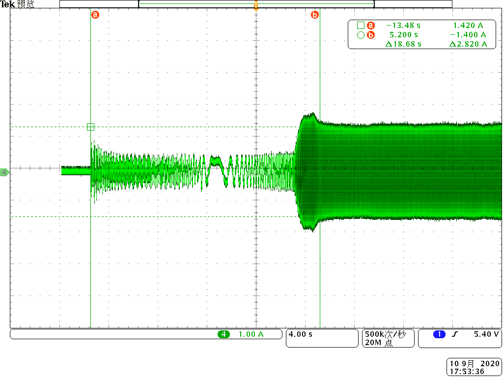

My customer want to test the motor starup performance with spinning reversely state. Here some issues:when the initial speed of the reverse rotation of the motor is large, the motor fails to start. The motor keeps reversing, decelerating and accelerating, and it cannot rotate forward. The test result will show in below table, and the motor information are:

Test results:

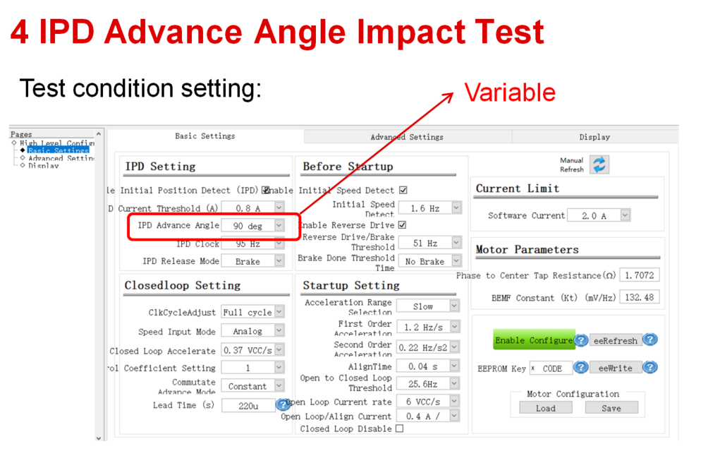

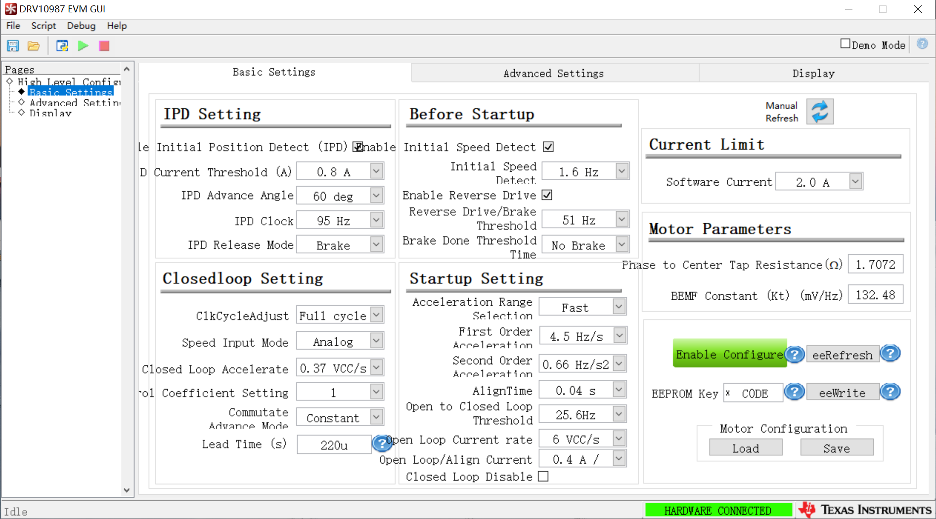

Parameters setting in GUI:

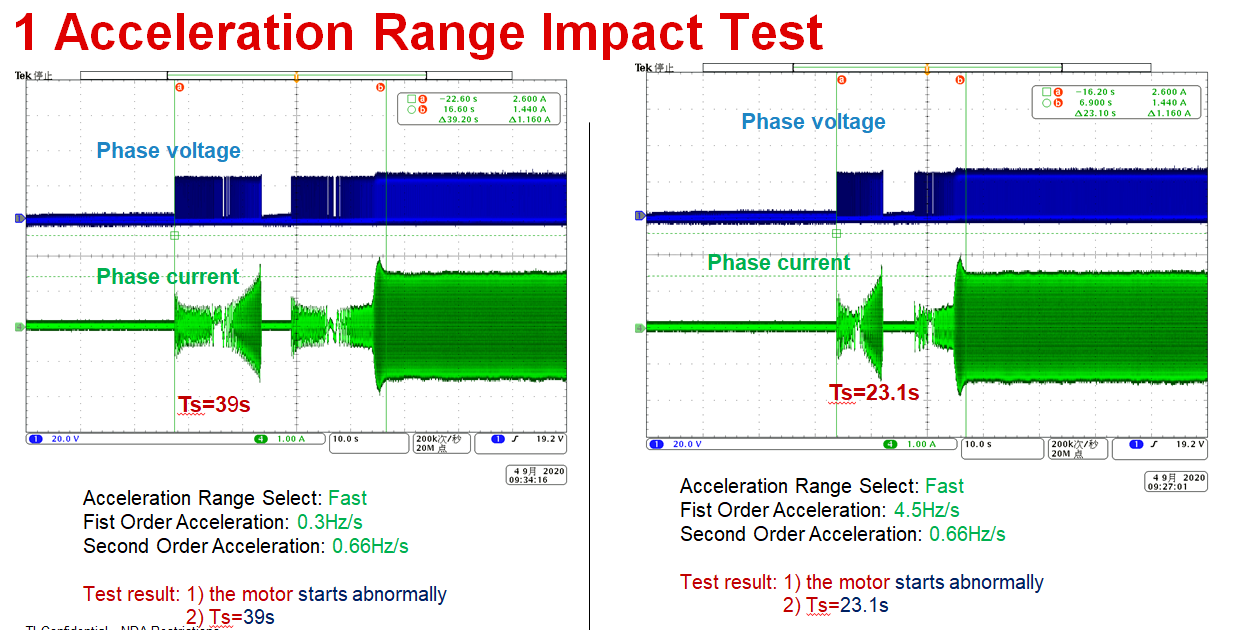

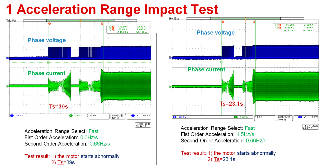

    Another test I have done:When the initial speed of reverse rotation is kept unchanged, changing the value of first order acceleration[A1] can affect whether the motor starts smoothly. When A>=9.2Hz, the motor can start normally; when A<=4.5Hz,the motor fails to start. Similarly, when the initial speed reaches a certain value, the motor fails to start.

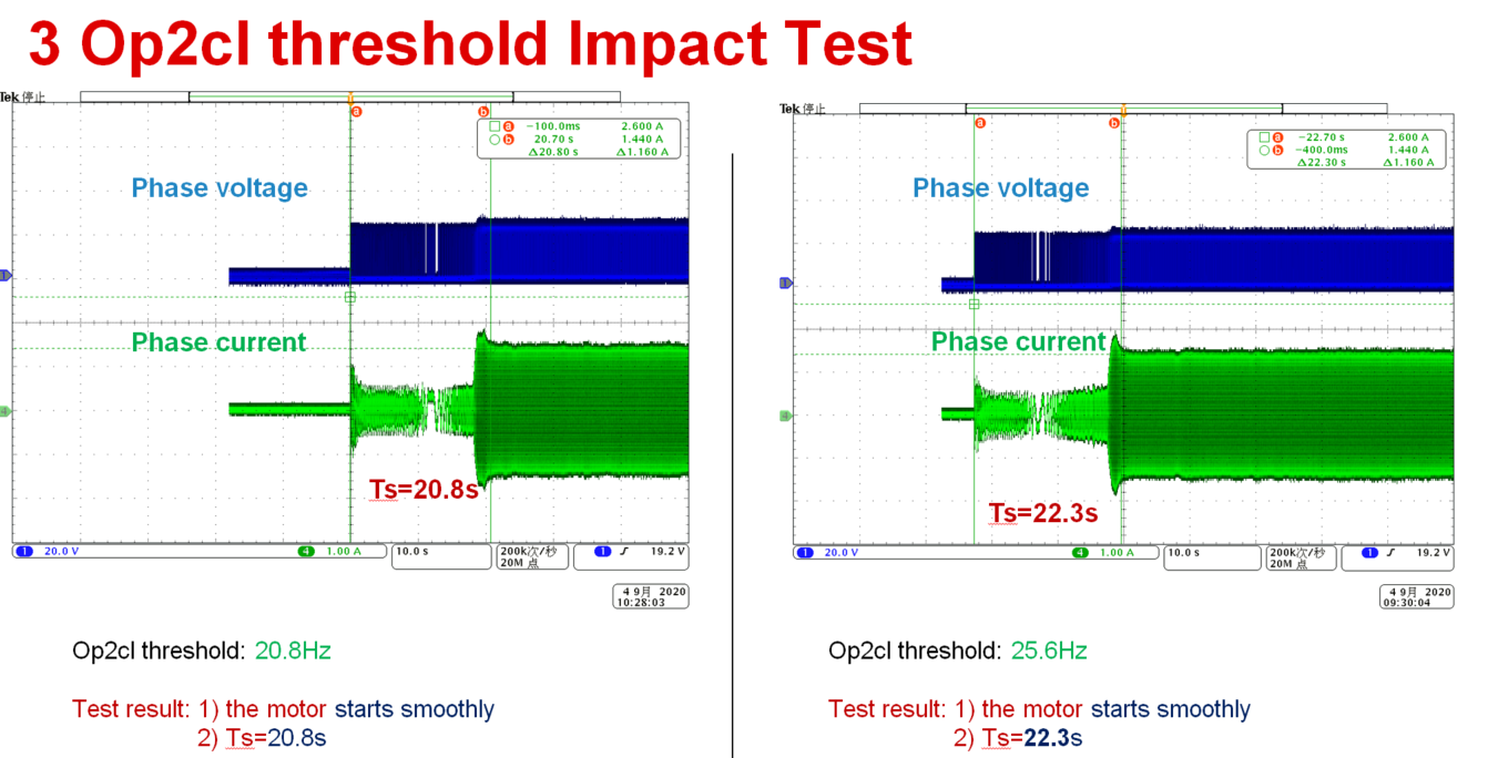

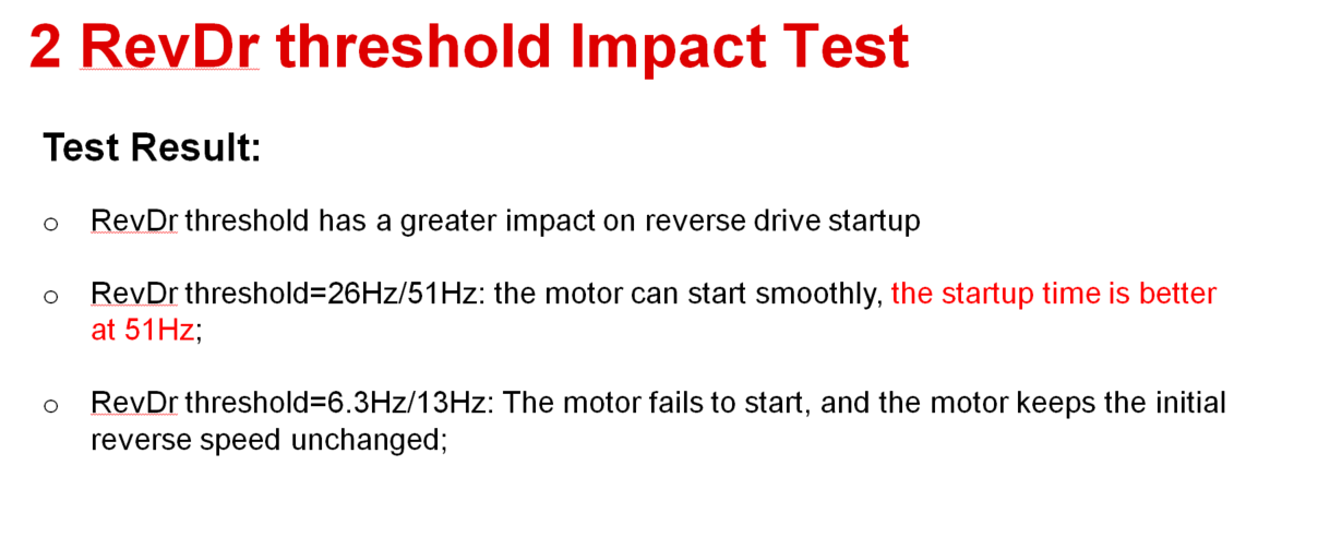

    I have do some lab test, and get some test result as below:
    • Acceleration range / RevDr threshold / Op2cl threshold has the great impact on the starting reliability and starting time of the reverse drive;
    • IPD advance angle have some impact on the starting reliability of the reverse drive;
    • IPD current threshold / ISD initial speed detect have some impact on the starting reliability and starting time of the reverse drive;
    Based on these test, the optimal parameter settings are as follows. Under these parameter, the motor can start smoothly, but the start time[Ts=19.7s] is still unacceptable:
    • IPD current threshold: 0.8A
    • IPD Advance Angle: 90°
    • Acceleration: A1=1.2Hz/s, A2=0.22Hz/s2
    • Op2cl threshold: 12Hz
    • RevDr threshold: 51Hz

    2. As shown in about parameter setting, the RevDr threshold is 51Hz. According to datasheet, the RevDr threshold needs to be reasonably low, if it is set too high, the current caused by the BEMF may damage the motor. So, how to optimize the RevDr threshold.

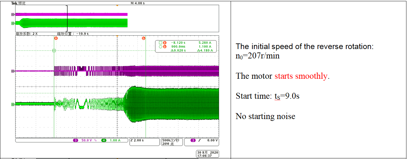

    The test report is as below, please let me know if you have any question.
    Thanks a lot.

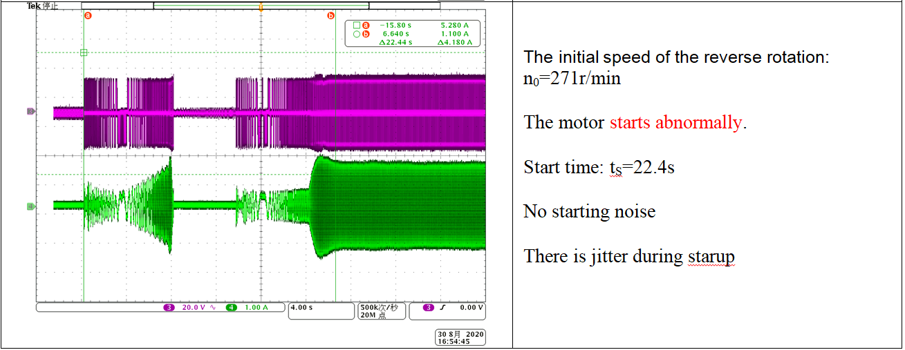

  • Hi, Vishnu
    Here adding a fault interface when the motor starts abnormally.
    Thanks.

    Some lab picture as below:
  • Hi Chester,
    Thanks for the details. Is the IPD disabled? I see from the GUI that IPD is enabled but the phase current tells me that align and go is enabled. Device stays in open loop for longer time, so clearly, A1 and A2 should be increased. What fault is getting triggered when you increase A1 and A2? Alos, you can try increasing closed loop acceleration to 48Vcc/sec but this will not decrease the startup time much.
    Vishnu.
  • Hi, Vishnu
    Thanks for your support. When I increase A1 and A2, the motor starts abnormally or fails to start. Please see the blow picture.
    Thanks.
  • What is the peak current drawn by the motor phases when you increase A1 and A2?
  • Hi, Vishnu
    The peak phase current is 1.5A.
    Thanks.
  • Hi Chester,
    I think this is a tuning issue. Looking at the GUI screenshots and the fault code, the estimated BEMF constant is 33 mV/Hz while the actual value is 132 mV/Hz and the device is triggering Abnormal Kt fault. I would recommend you to tune the lead time till the device estimates 132 mV/Hz.
    Vishnu
