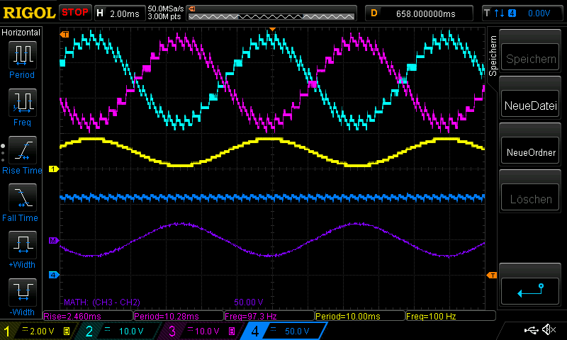

DRV2667: Analog input amplitude
I did take another Screenshot (see below) where you can see the ripples clearly. I used Rext=13k, Lboost=3,3 µH whis is on the DevKit as well. The voltage divider was set with 680k and 9k. The signal on channel 1 is what i put in on the Analog Input. I dont unterstand why I can't get a full scale signal from +/-200V. Do you have an idea how the amplitude on the analog input should look like? I tested this signal with the DevKit as well and it worked fine. I hope you have an idea on this. Thanks for your help!
The measure was taken without load.
