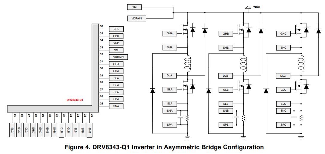

    We like to refer to this app note to discuss SRM motor circuits. Are you implementing an asynchronous or miller bridge configuration (figures 4 and 5 from the linked app note)? Or some other configuration? Can I see your schematic?

    1) I am using asynchronous bridge configuration.

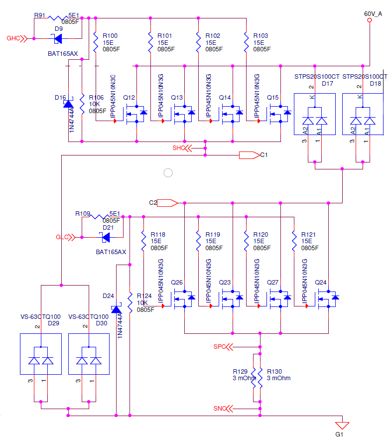

    Refer the schematic attached.
    kaarthi
  • Hi Kaarthi,
    Thanks for sharing the schematic!
    I see that the MODE pin is configured to be 6x PWM (MODE tied to GND). I think for proper SRM operation you need to use the independent PWM mode (MODE pin tied to DVDD) so that the high-side and low-side MOSFETS can be on at the same time. In 6x PWM mode the high-side and low-side FETs in the same 1/2-H bridge cannot be on simultaneously.

    SRM documents/articles:
    • This is a much older app note related to SRM drive: LINK
    • SRM motor position estimation: LINK
    • Control using DRV8343-Q1: LINK
    • Motor Control Compendium (page 71): LINK
    • Switched Reluctance Motor Control – Basic Operation and Example Using the TMS320F240 (attached to post) - spra420a.pdf

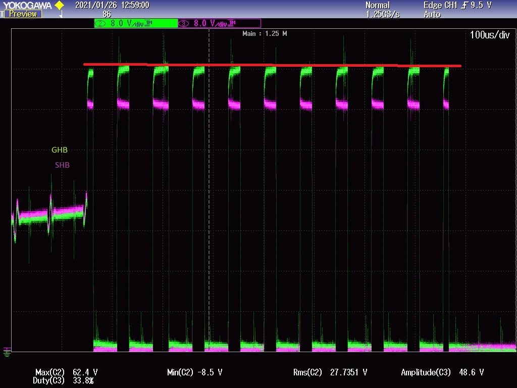

    You have a very small voltage scale, so it is difficult to be sure, but it looks like phase A is not being fully enhanced on the high-side MOSFET. From your last waveform SHA is ~48V while GHA is also around 48V. On phase B (waveform #4), SHB is ~48V while GHB is closer to ~58V as expected. As I mentioned, it is hard to make out from this scale.
    Can you take waveforms #3 and #4 again with a different voltage scale? Can you overlay GHx and SHx on the same plot with 5V/div or less for channels A and B?
    Please confirm that the gate-to-source zener on phase A is not broken (the equivalent of D16 on phase C), as this could be clamping the voltage.I noticed that this component has a non-repetitive peak reverse current limit of 300mA which is much lower than the gate drive current.
    Matt
  • Hi matt,
    Please look at the attachment of phase A and phase B showing GHx and Shx, The waveforms taken at 8v/div.
    1) Phase A - Green - GHA, Pink - SHA,
    2) Phase B - Green - GHB, Pink - SHB
    From the above waveforms, we can clearly see that the gate voltage amplitude is completely different from faulty phase and working phase.
    We checked even by removing that VGS zener diode on all phases, this results same.
    One more thing we noticed is, on the faulty phase the VGS resistor showing 45 ohm only actually it is 10kohm. On other phases it is showing 10k(including bottom of phase A) . We removed the resistor and checked the same , it is showing 10k.

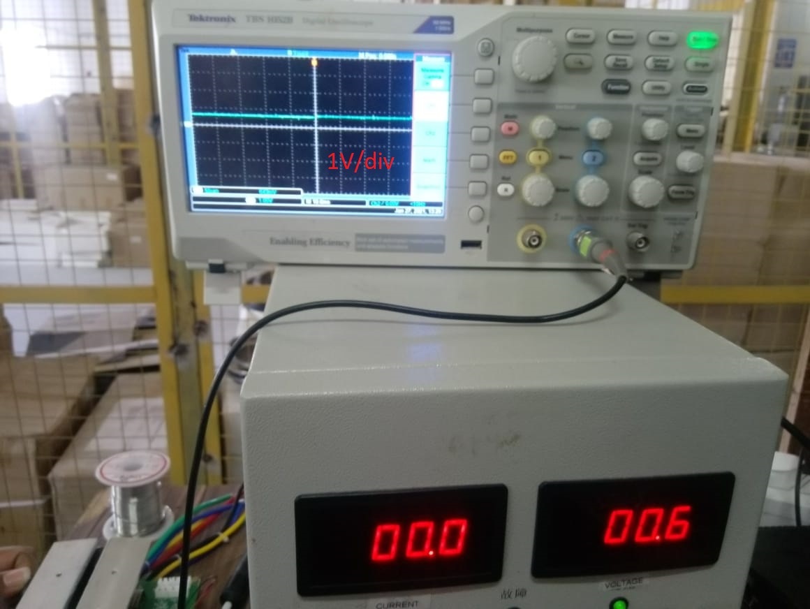

  • Hi Matt,
    Once we removed the 10k resistor, still it was showing 45 ohms with gate driver on board. So, we removed the gate driver, then its not showing 45 ohms.
    We also did curve trace as you suggested in your previous post. We gave from GHx to SHx, it seems ok. Find the following pictures,
    1) Applied voltage - 0.6V, Scope scale - 1v/div
    2) Applied voltage - 3.0V, Scope scale - 1v/div
    3) Applied voltage - 6.8V, Scope scale - 2v/div
    Kaarthi

    It is clear that the charge pump (VCP) is not damaged, which aligns with our assumed root cause: damage to the high-side gate driver sink
    Turn off test is eeded to check if there is a significant voltage spike on SHx: Measure SHx, GHx, GLx, and load current on an oscilioscope. Turn on GLx and afterwards turn on GHx to let large current flow through the load. After a little bit of time, turn off GHx. Trigger scope capture on falling SHx waveform and zoom into 100-500ns so we can check for any significant negative voltage spikes at SHx.
    My theory is that the clamping diodes (i.e. D29, D30) are too slow to catch and cause negative voltage spikes to occur on SHx when the high-side MOSFET turns OFF. You may want to look for a faster diode (maybe not a Schottky) to use. Alternatively, you may need to add capacitors on SHx to GND to help absorb some of the energy.
