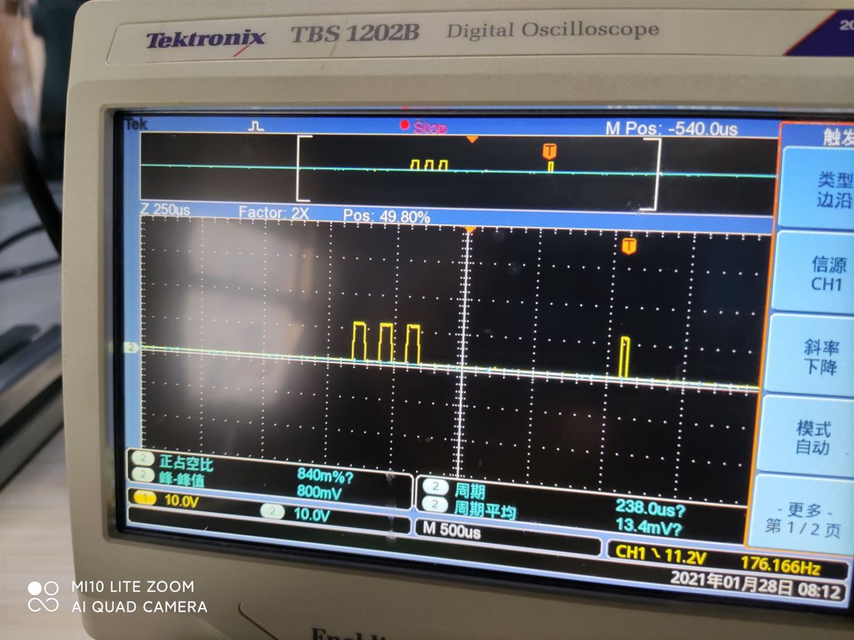

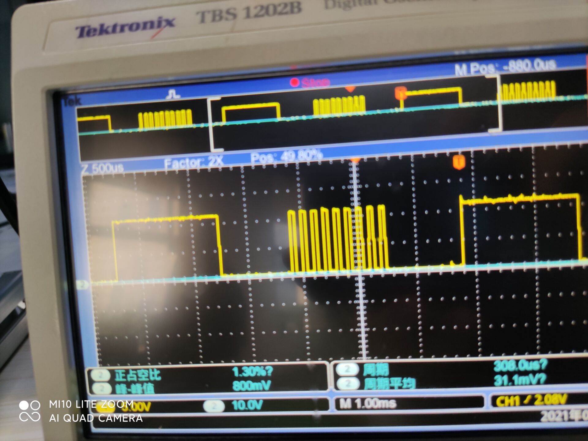

    The slx glx signal ,u can see it in the picture.I also add the vgls. U can see the vgls and gla is wrong. It seems lose some duty cycle.The vgls should be  stable
    11V but there is  aperopdoc oscillation .I have test the INLA from MUC. It‘s normal but the Drv8350 output wrong pwm. The Idrive is 2000mA and 1000mA.
    If go by u guess,the what did the high Idive destroy? Because we have proved the drv8350 is good,it is strange right?

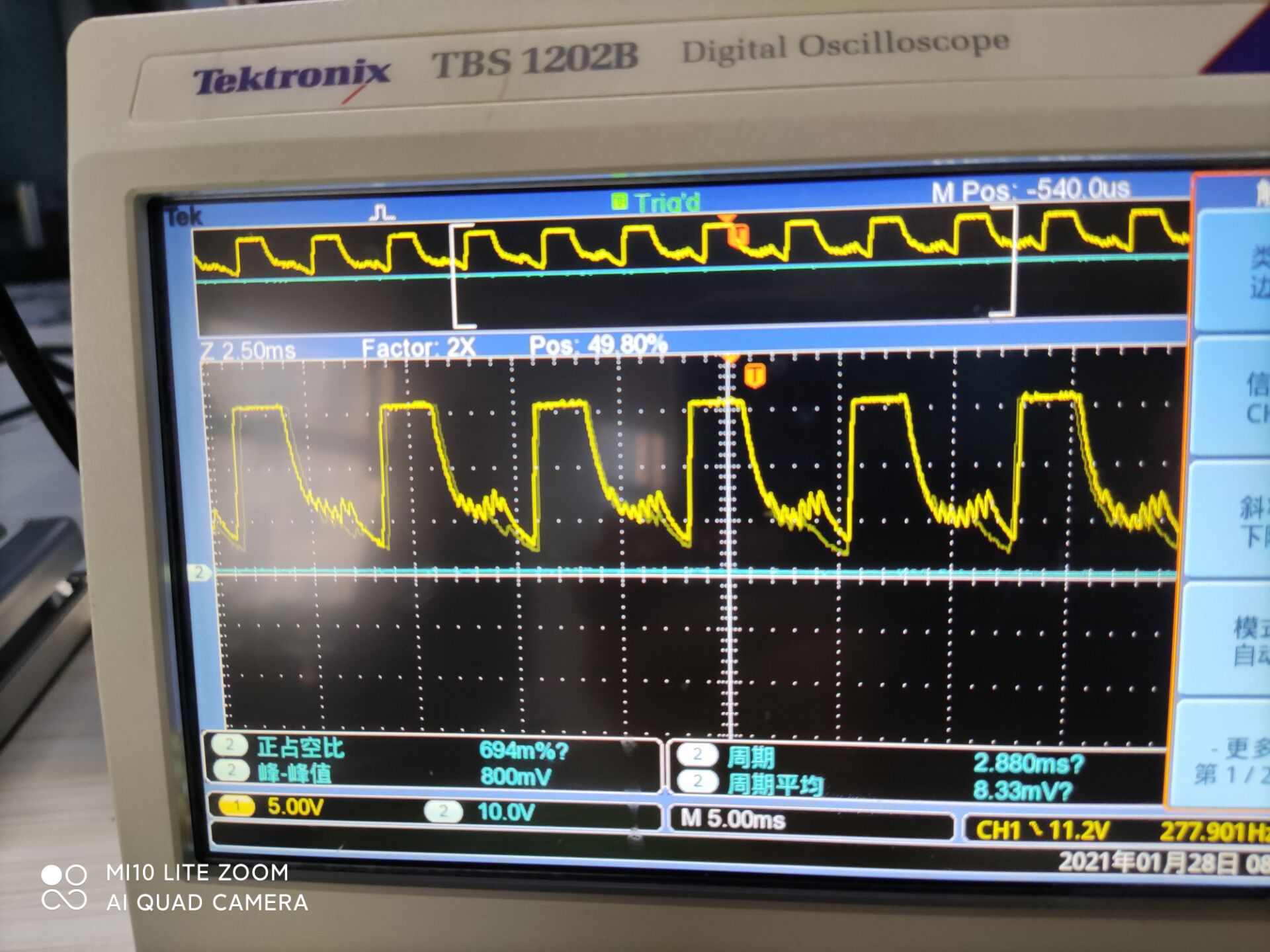

  • this is vgls .The next one is riigh glx and wrong glx
  • Hello Shengzhong,
    The device replaced on a different board recovers, which implies an issue on the board. That is strange.
    We do not recommend using the highest IDRIVE setting, since this has been shown to cause abnormal behavior or possibly damage. We generally recommend setting IDRIVE so that QGD / IDRIVE is between 100 and 300 ns. You are using a very small MOSFET CSD88537ND, so we recommend the lowest setting of IDRIVE 50mA and change the series resistance to 100 ohms to further limit the current. This may not be the specific issue happening here, but definitely make the change to improve robustness.
    Ensure that the VGLS capacitor on the problematic part is making good contact with the board (no cold solder joint). The layout of the VGLS capacitor can be critical - make sure the traces from VGLS pin to the capacitor as well as capacitor to GND pin #30 are as short as possible. You can try increasing the voltage rating (16V to 20V) or value (1uF to 2.2uF) of the VGLS capacitor.
    If you are able, check the VM pin during operation to ensure it is not decreasing, and also verify that there is no ground bounce going on that may cause issues.
