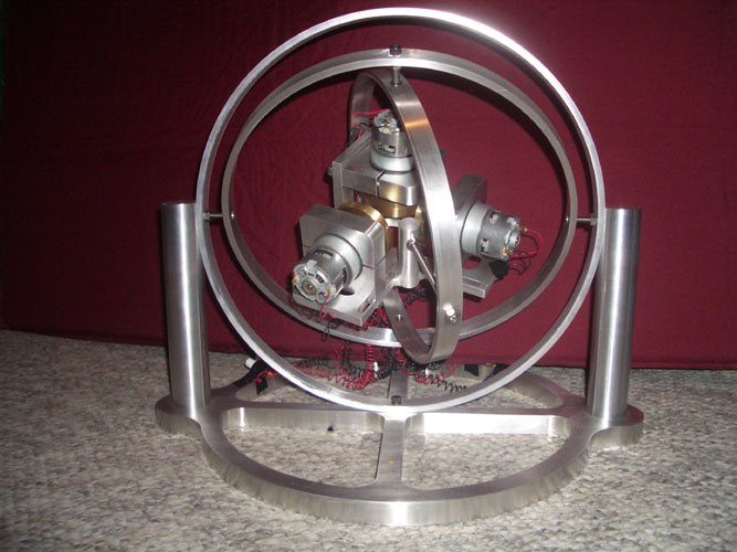

    Do you know if TI will ever develop a similar board like BOOSTXL-DRV8301 as shield for the Arduino instead of just for the LAUNCHXL platform?
    Thanks for the information about the BOOSTXL-DRV8301 though.  I might order one just to see if I can control our our reaction wheels test system using the Arduino or the IOIO board.

    Cool looking contraption!  Are the motors geared inside those cubes?  What's the typcial speed command range to the motor shaft you are giving?
  • Chris,
    Those are Faulhaber brushless DC motors. They have a maximum rotation rate of 60,000 rpm.  However, we only need a maximum of 50,000 RPM since that will be sufficient to generate a rotation rates of +/- 15 degrees/s around the X and Y-axes, and +/- 34 degrees/s around the Z-axis.
    Thanks again!

  • Thanks Chris.  That is exactly what I thought I could do (i.e. "wire it into the Arduino").
    We use PID to control them and SPI to communicate with all 3 motors.
  • Do these motors already have a controller integrated?
    If you are controlling them yourselves what sort of commutation/modulation scheme are you using?  Using hall sensors, encoders, or software for rotor position estimation?
  • No, they don't have a controller integrated.
    They use hall sensors.
