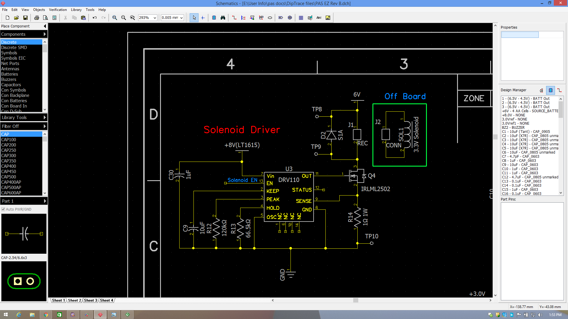

I have a solenoid I'm trying to interface with the DRV110 that does not seem to be working quite as I had hoped.
The solenoid electrical specs are as follows:  3.3V nominal operating, ~10.70 ohm coil, 5mH inductance, roughly 325mA to open with a hold current of 75mA.

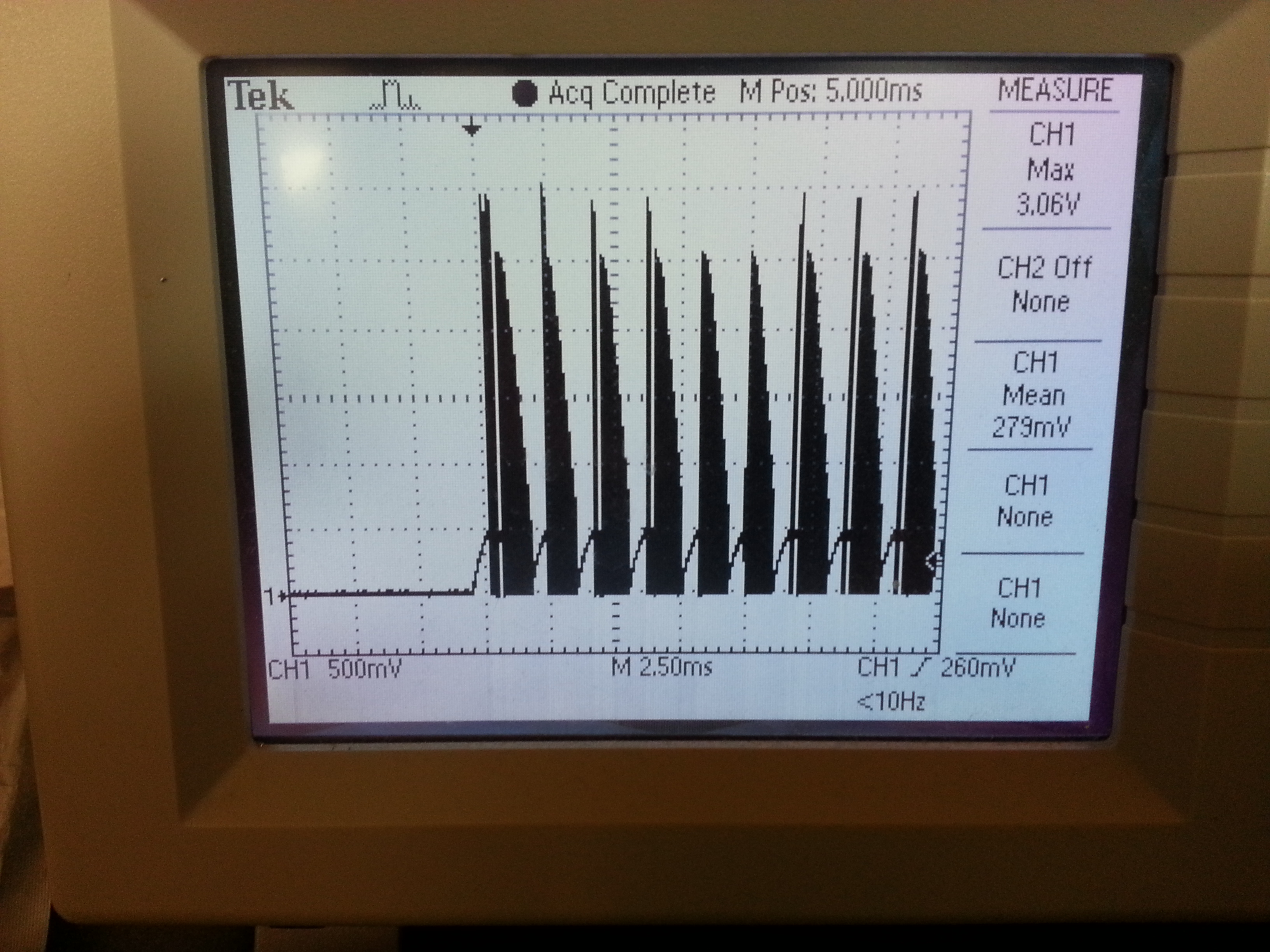

Attached is the schematic of the solenoid driver circuit I'm using. With the external components I selected I should see a 1sec peak time at 500mA, followed by a 150mA hold. The solenoid opens most of the time, although it struggles at times. Attached is a pic of the voltage across the sense resistor at the start of the peak fire. If the mean voltage value is accurate(~280mV) then the voltage reference across the 1ohm resistor is producing ~280mA worth of current. This would account for the struggling opening.

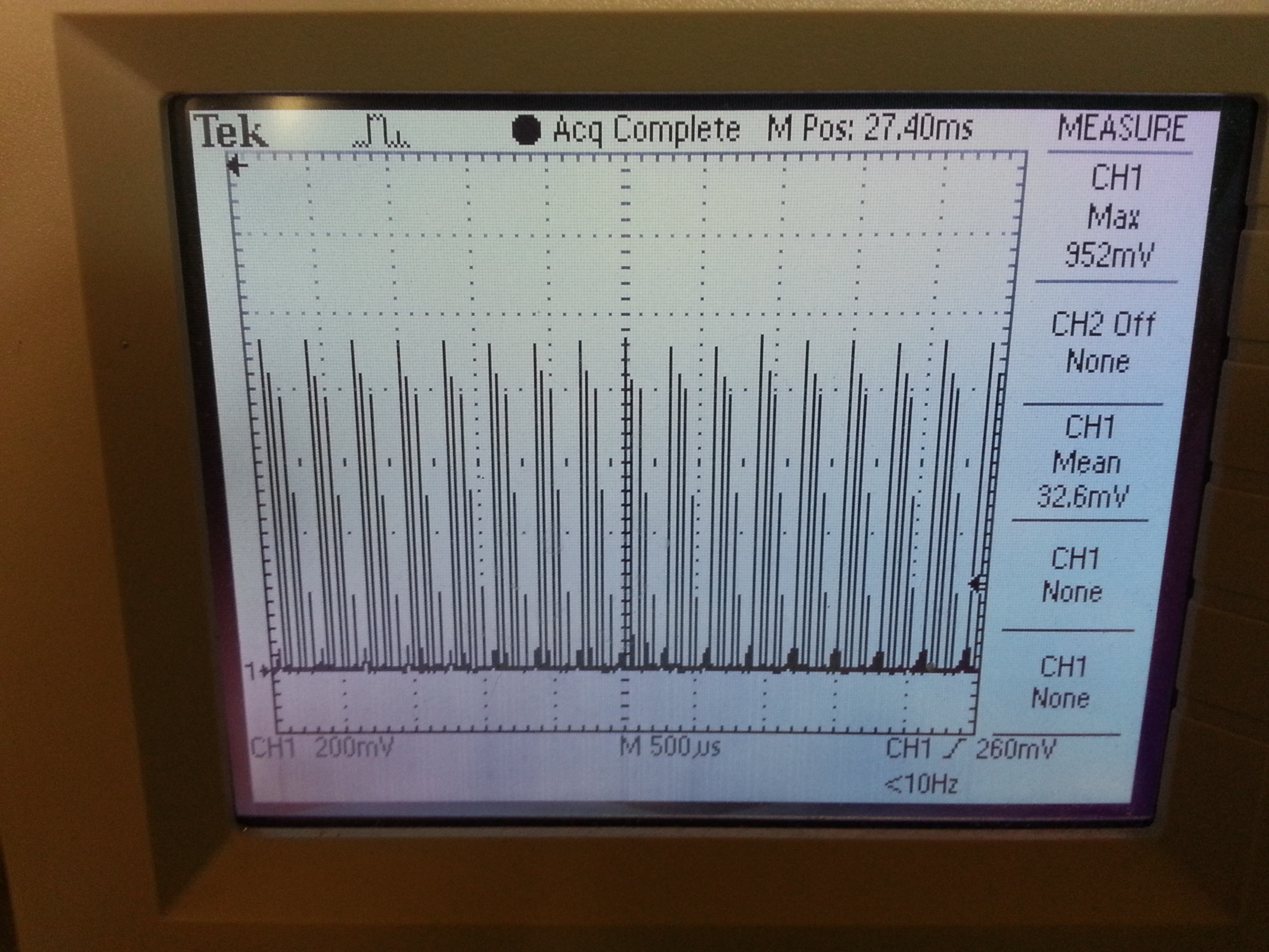

Also attached is a pic of a portion of the hold sequence voltage across the sense resistor. With a mean of 32mV it correlates to the measured current of the solenoid of approximately ~30mA during the hold sequence that I'm seeing. The solenoid immediately closes once the peak time ends due to the hold current being too low.

Initial peak fire:

    As long as the passives are close to the chip, I don't think there should be any issue from layout.
    One thing you can try is putting an RC filter between the sense resistor and the SENSE pin. The DRV110EVM User Guide (http://www.ti.com/lit/ug/slvu686b/slvu686b.pdf) shows where to put it in the schematic. You can try doing this with larger values of capacitance too.

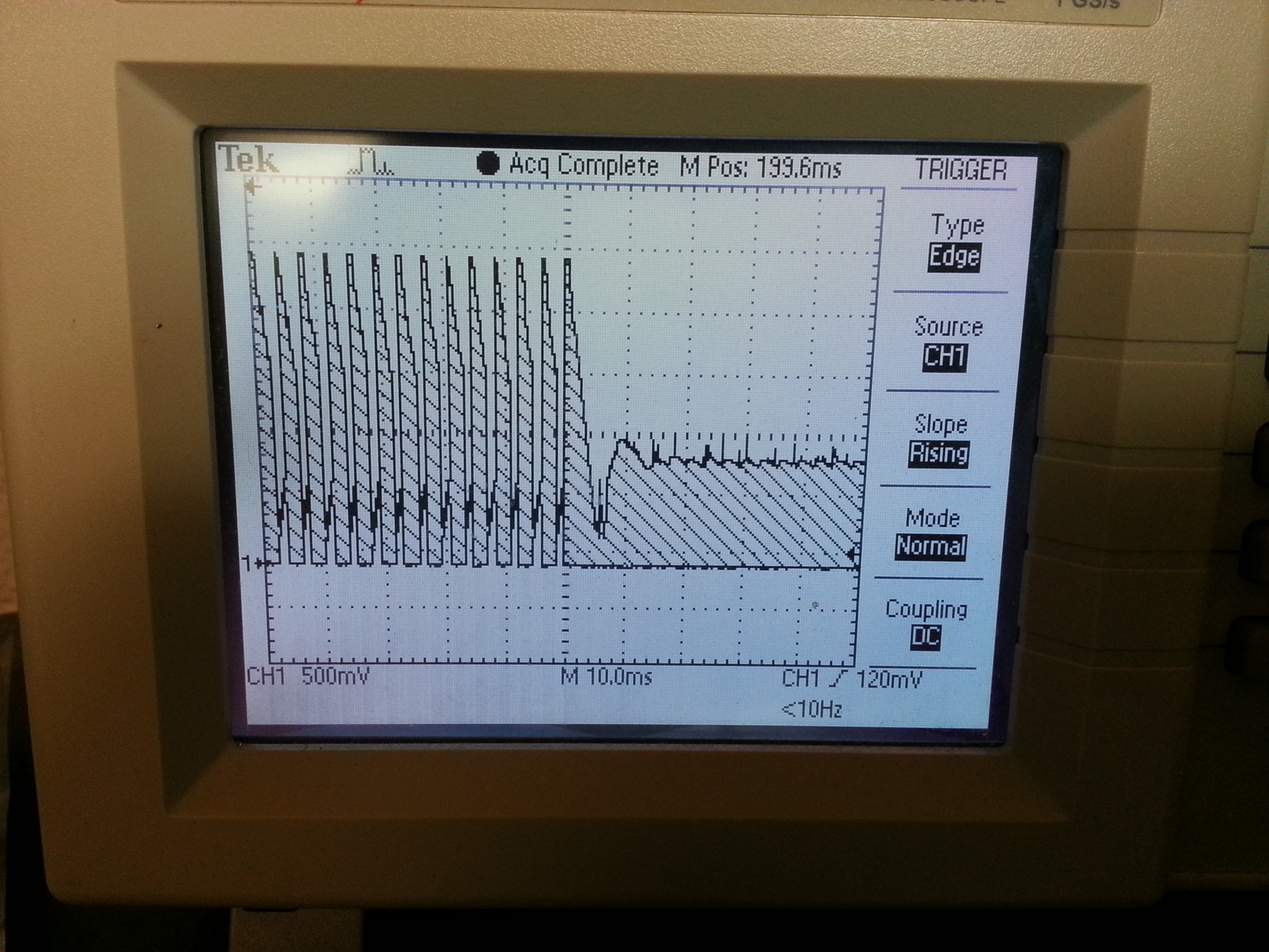

    First and foremost the current regulation is dead on for both peak and hold portions of the control scheme, but I was still having an issue with the solenoid returning to its normal position during the transition from peak to hold. And here is voltage across the sense resistor. You can see where it transitions from peak to hold it would drop out, and the solenoid would return back to it's normal position. This is without a low pass filter installed.

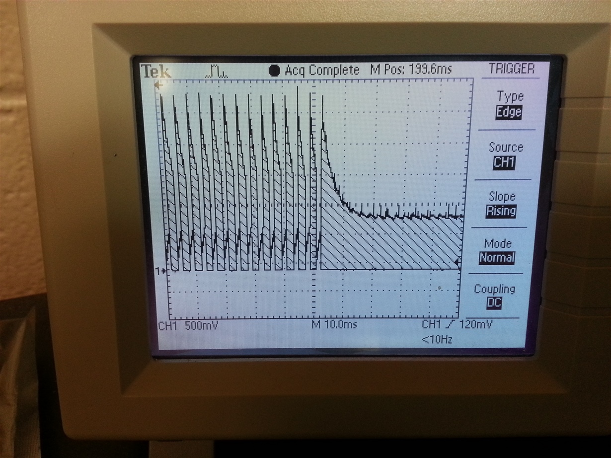

    I installed a low pass filter, which required over 220pF of capacitance for proper function, and now it transitions flawlessly from peak to hold. Here's what the transition looks like now with the low pass filter:

    I have the hold current set to max of 150mA, and the DRV110 is regulating that well. It was the drop out that was occurring on the peak to hold transition prior to the low pass filter install that was causing the solenoid to return to its original position. Once the filter was installed that dropout disappeared and the solenoid remained in its powered position.
