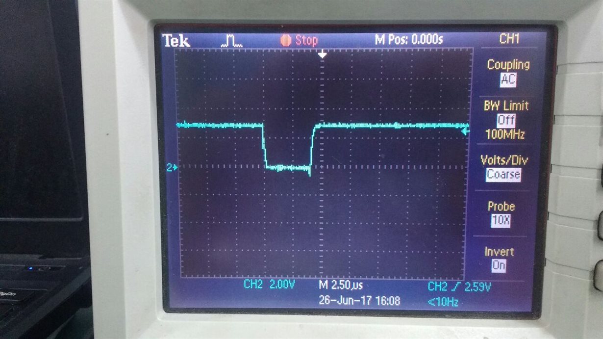

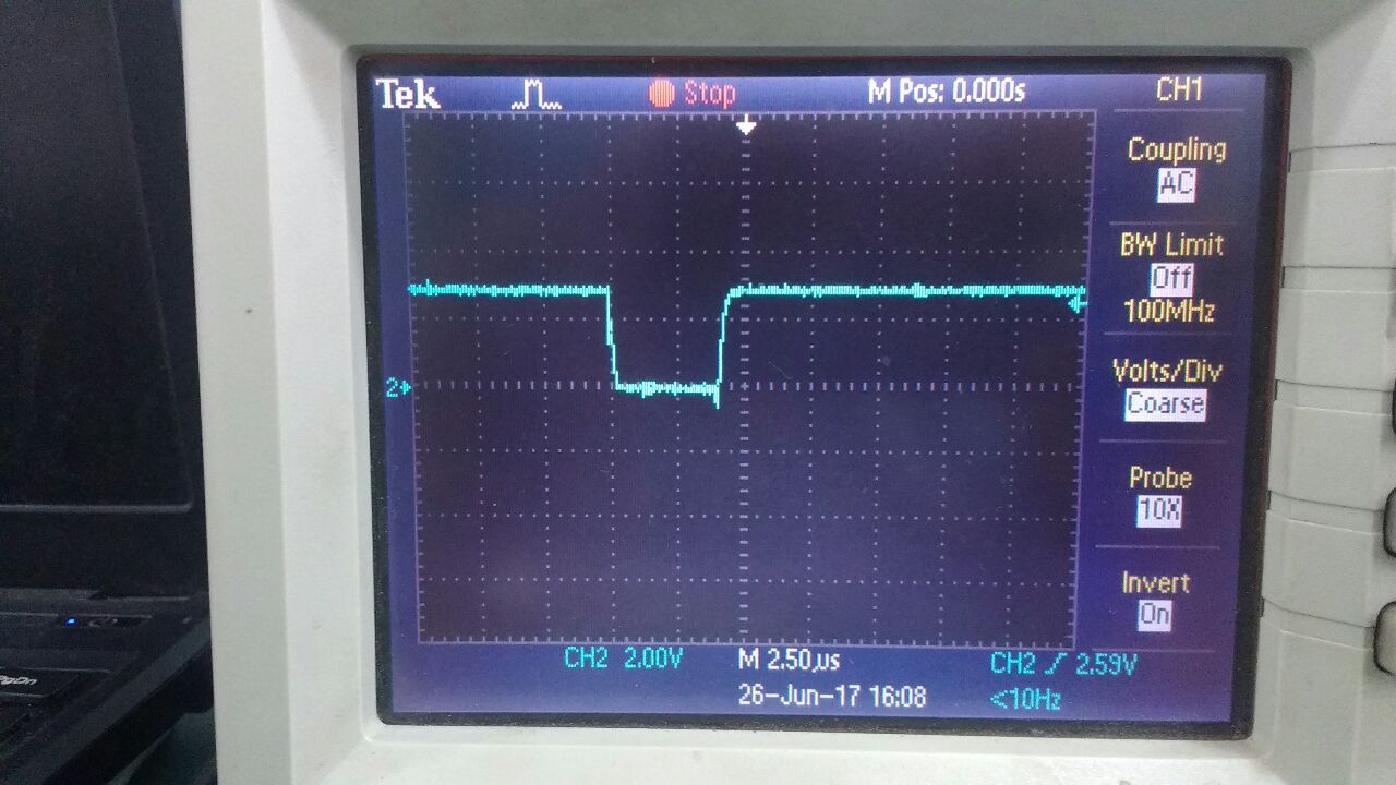

  • Hello Rick,
    Thanks for your reply.
    Below attached image describe signal  between output 1 and output 2.
    We checked with 3.3v power supply to motor directly then vibration is same as 100% duty cycle.
  • Hi Chintan,
    If the motor vibration is present when connected directly to the power supply, please work with the motor vendor to determine the reason.
