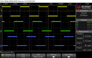

  • Hi Antony,
    The scope pictures are attached and is as below.
    Motor Wire Combination 1 AntiClockwise:
    In Combination 1, the motor rotates in both directions and the speed is same. Hall sensor is at around 200Hz
    Combination 1 Clockwise:
    Motor Wire Combination 2  Anti Clockwise:
    In this combination and in anti clockwise rotation, motor runs at very slow. Hall sensor is monitored at 120Hz
     Motor Wire Combination 2  Clockwise:
    In this combination, the motor runs at a very high speed in clockwise direction. and the monitored hall sensor speed is at 270Hz.
    Since this is the highest possible speed monitored, I thought the motor runs at very low speed in opposite direction.
    By analysing the and comparing with the limited data from the motor manufacturer, I believe, the combination 1 is perfect as the motor runs at same speed in both direction.
    But then, based on the trials, there is a way to run the motor even at a higher speed. Can we ustilise this high speed combination and how is it acheiving this higher speed than the spec.

  • Hi Jamshid,
    After discussing your question with a coworker it seems like combination 1 is the proper hall/phase alignment, resulting in commutation in both the forward and reverse direction at the same speed and with less current consumption than hall/phase combination 2. From your post it seems that the motor is operating out of its specifications in the clockwise direction in the case of combination 2, This could be a result of hall/phase misalignment that could be causing interference with the magnetic fields and producing field weakening which could cause the motor to operate outside of the normal parameters of the motor (resulting in a higher RPM than the motor is rated for). When commutation is reversed this effect might not occur, and due to the misalignment of the halls/phases in combination 2 the speed would be drastically reduced.
    Anthony Lodi
