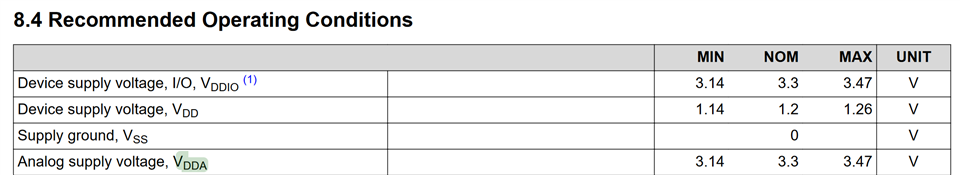

  • Hello Koki,
    Damaging the ADC:
    Looking at the datasheet, it looks like VDDA is 3.3V typical, with an abs max of 4.6V (in relation to VSSA) where the maximum V_REFHI should be at VDDA or typically around 3V. The notes say the inputs and V_REFHI should be kept below VDDA + 0.3V or risk damage. See applicable tables below. So, 3V or 3.3V for the V_REFHI works.
    This means, exposing at the typical VDDA (or 3.3V) at the input, should be fine for operation but the output of the ADC will treat it as 3V (assuming _VREFHI is 3V). I don't know enough about ADC's as to why the default or typical configuration is that the reference voltage is less than the supply voltage for the ADC, but I'm sure there's a reason because its very very common.
