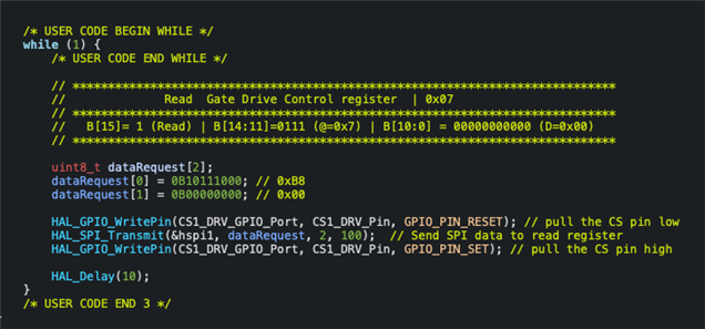

and everything seems to be OK, as expected.  Then to check if my DRV it alive i decided to check the SPI communications trying to read  Gate
Drive Control register with this code and  SPI configuration as shown in the following images:
Code used:
Configuration of SPI:

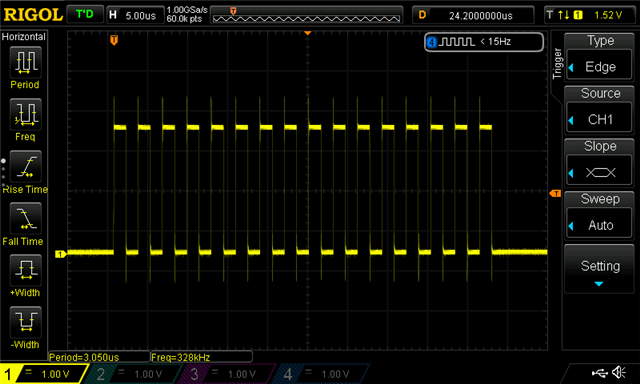

With an oscilloscope I can check that CS, CLK and MOSI are arriving to DRV8305 as shown in the next creen captures (CS,CLK, MOSI) :
Unfortunately the pin corresponding to MISO does not show any data, the line remains at zero value. Not sure what can be wrong.

    In your schematic the MISO (Master Input, Slave Output) pin is connected to the SDI (Serial Data Input) pin of the DRV, and the MOSI (Master Output, Slave Input) pin is connected to the SDO (Serial Data Out) pin of the DRV. These need to be switched, since you want the Master Output going to the Serial Data Input of the slave device (MOSI connected to SDI) and you want the Master Input connected to the Serial Data out of the slave device output (MISO connected to SDO).
