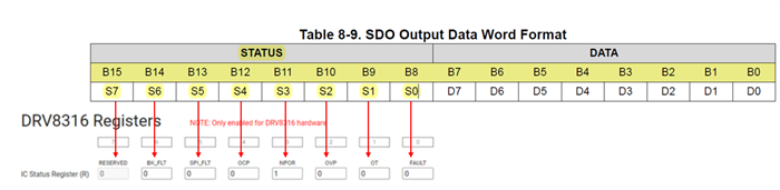

Hi Team,
I understand that the status bits are as follows.
Is my understanding correct?
S7 :RESERVED
S6 : BK_FLT
S5 : SPI_FLT
S4 : OCP
S3 : NPOR
S2 : OVP
S1 : OT
S0 : FAULT
Hide
Hi Hide,
Thank you for posting your question!
Your understanding of the status bits are correct, the status bits correspond to the IC status register bits in the same order as you described.
