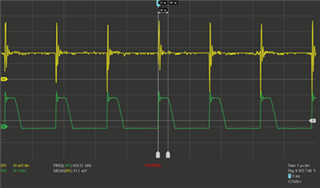

    First I measured the I_out via a shunt at the output (yellow 1mV = 1mA). The green curve represents the waveform of the switching node.

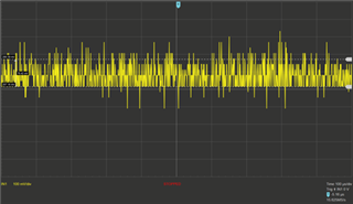

    The second measurement shows the voltage drop across R_Sense.
    The measurements are carried out with an output voltage of 6.6V. The output voltage changes up to 7.3V when the input voltage is changed from 9V to 30V.
    LED_PKTH_DAC = 78 (20mA)
    V_In = 9V:
    1.
    f = 160kHz
    D = 0.77
    I_out = 19.2mA
    V_out = 6.6V
    2. Voltage over R_sense = 2.2Ohm
    Here you can see that the voltage drop follows the expected course. The measured V_peak = 78mV
    V_in = 30V
    1.
    f = 616kHz
    D = 0.20
    I_out = 33mA
    V_out = 7.3V
    2.
    Here it was not possible for me to carry out an evaluable measurement. But still if you ignore the peaks and the inaccuracy of the resolution of my oscilloscope due to my measurement (for this measurement a resolution of 49mV per step), it is still close to 78mV peaks.
  • Hello Matthias,
    Thank you for the scope pictures.  Notice on the switch node waveform at 30V input that the fall time fall-time is longer than at 9V input?  What I believe is happening is at low current the switch node cannot slew very fast causing an increase in average current.  When the TPS92518 reaches peak current threshold the MOSFET turns off.  The inductor is still seeing voltage applied to it as the switching node is slewing down creating an actual higher peak current.  Also the off-time starts when the peak current threshold is met creating a shorter time for the inductor current to fall (when the freewheel diode is conducting).  These two things will make the average current higher.

  • Hi Matthias,
    So I can't find all the information such as the winding capacitance of the inductor however I think the MOSFET is probably dominate here.  If you look at Coss on the datasheet from 30V down to zero I took a low value of 200 pF.  The freewheel diode also has some capacitance so it will add to this but just using 200 pF and the peak current of 35.5 mA and 30V I get a slew time of 170 ns.  I can't see the time base of the scope picture above to compare however at 500 KHz that is 8.5% of the switching period.  It will be more due to the diode and MOSFET non linear Coss.
    The MOSFET is definitely too large for this current level.  even at 100% on-time the conduction loss is less than 1 mW at 100 mA.  The diode is on the large side as well.
    I'd fine parts with lower parasitic capacitance and possibly design for lower switching frequency (larger inductor) if it's still an issue.
  • Hi Irwin,
    the measured slew time at 30V is actually about 200ns and therefore >170ns as you said.
