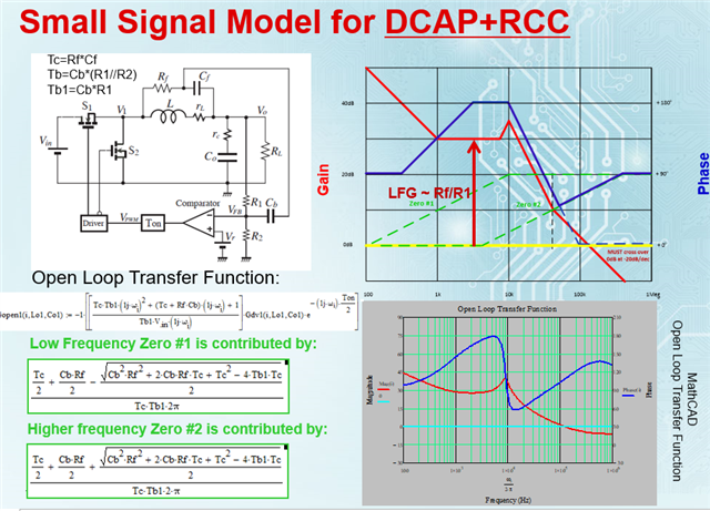

  • Hi Jimmy,
    To answer your questions:
    1. While there is an open-loop transfer function of a DCAP control topology, the output voltage is compared by a comparator as opposed to an error amplifier, which essentially has infinite bandwidth, so the Bode Plot is not necessarily meaningful.
    2/3. The RL/CL/CC contribute to a low frequency and high frequency zero when modeling the open-loop transfer function. The image below details the derivation.
    4. While Bode plots can be convenient, Load Transient stability is a better arbiter of stability when characterizing the performance of the TPS53355 in your design.
    5. I have not calculated your schematic's transfer function, but I would argue that your higher frequency zero is contributing to the rise in the phase curve, which is not crossing over. This is not necessarily important in a DCAP part.
    6. The ESR of the output bulk capacitors acts as a current sensing and summing element in the DCAP topology. Equations 7 and 19 in the datasheet detail the impact ESR has on performance. Based on your schematic, you have sufficient output capacitance and acceptable ESR for stability and jitter performance.
