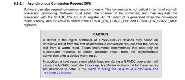

*I found a similar thing mentioned on page 53 of the datasheet ! So this is TPS65903x-Q1 defect ?
If so, how could I solve this problem? Thank you*
  • Hi Kygo,
    I do not think this defect is related to the customer issue. Can you provide any scope shots of what happens to the device when they try to start the device up? Do any of the output rails ever enable or is the device always in a disabled state?

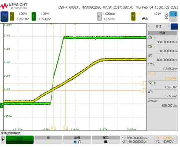

     Now have a cold rest issue , attached is the SCH :
    (1)There is failed PMIC (PN as below) was returned from customer.
    The symptom as below
    1. It work fine at normal temperature (15~ 25 degree C)
    2. It can't be powered up at 0 degree C. it can't be recovered with H/W reset, too.
    3. If it was powered up at normal temperature, and then lower down temperature below 0 degree C, it can still work fine.
    4. Customer tried to re-solder this PMIC again to eliminate the cold-soldering problem if it had, but it still can't be recovered.
    TPS659039-Q1/O9039A385IZWSRQ1, 169 pin FBGA
    (2)Power up steps and Waveform as below
    5V0 and 3V3 are come from different buck regulators and they are directly connected to 12V car battery.
    12V ---> Buck 6.1V (Cameras power) ---> LDO 5V0
    12V ---> Buck 3.3V (PMIC and others)
