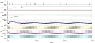

From the excel calculator, 75uH of Lout is recommended under the condition of 50Vin, 28Vout, 2Aload. But unavoidably customer has to go with 22uH of Lout. So I tried to simulate it with a TINA model as attached, where I ran into problems below :
1. I applied 500mA of load. As you can see in capture1, it regulates into 28V well but I'm not sure COMP waveform is a normal waveform. Please check and advise on whether Vout is well regulated with the correct COMP waveform.
2. I applied 2A of load and it shows abnormal VOut regulation, only upto 16V, as attached in capture2. Why is it not regulated?
LM5576_22uH_snvmbp5.TSC
Thank you!
Capture 1 & Capture 2

  • Hi Ella,
    1. Vout is regulated. Notice how the FB voltage is ~1.225V as it should be.
    2. Looks like it is hitting current limit.The low inductance value has lowered the max output current range. Current ripple increases with decreasing inductance. Notice how the COMP value is fixed (error amplifier is asking for more power) and FB is staying well below the ~1.225V regulated voltage.

  • Alejandro,
    Please see the capture2, not 1. Vout is not regulated with increased load (2A). The target Vout is 28V. (I set R5 = 22.2k and R6 = 1k following the eq (15) in DS.) FB is only <0.8V, but it should be 1.225V as you mentioned.
    Could you advise why the LM5576 doesn't regulate the output when the load increases? I'm sure Rramp and Cramp are designed well following eq (3) and (4) in DS. Maybe COMP pin components are the issue?
  • Alejandro,
    I found the problem. The low frequency (approx. 286kHz with R_RT=21.6k) was a problem as it triggers current limit as you mentioned. After I change R_RT 10kOhm, thereby the switching frequency becomes 518kHz, I'm able to get 28Vout with 2A load.Thank you for your advice!
