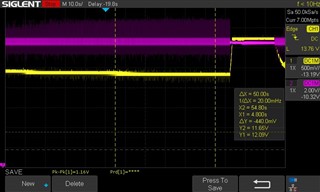

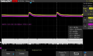

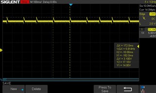

    Images below.  Order is Vcc (inout voltage), PH voltage, PH voltage on working board, Vbatt (output voltage), zoomed in Vbatt and output current (best I could do is a math function on my oscope across the sensing resistor).

       These peaks occur when the battery is charging.  I checked the other design and the same thing happens, but stops when the charging is complete.
      PH pin
      PH pin of working board
      Vbatt
      Zoomed in Vbatt (clicking noise is happening when the spikes are present)

    Pictures below: Yellow is Vbatt, Pink is VCC
      Zoomed out
      zoomed in a bit more
      zoomed in
      better resolution on Vbatt
    We do not recommend running buck converters on full duty cycle. With efficiency losses and parasitics, you could be trying to operate the buck converter with a 15 V input and 14.4 V input at maximum duty cycle. That is why I recommended to increase the input voltage.
    Can you please take a waveform of PH on the working board with the input voltage at the same time? I want to see if the triangular noise on the input is there.
    Can you investigate why you have a triangular waveform on the input?
