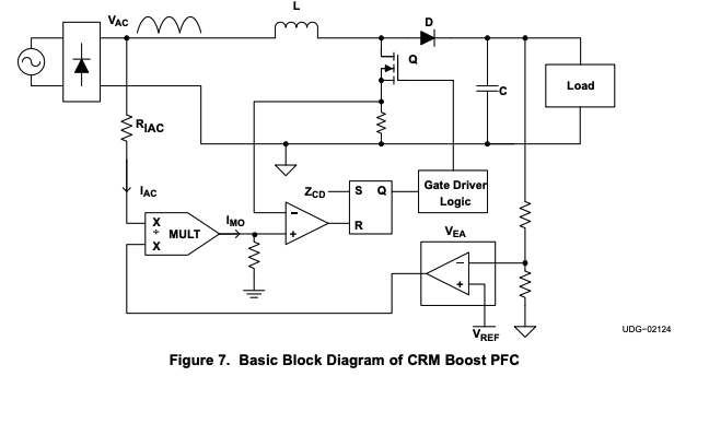

Hi Expert,
Will need to clarify why there is no DRVOUT during AC input lost.
Conditions:
--PFC stage is running under AC input
--Turn off the AC input for serval AC cycle (60Hz) then turn on the AC input back
--VCC is in the biased and keep in the regulation still during AC lost
Results and support need:
No DRVOUT during AC input lost is observed.
Once AC input is back, the DRVOUT will resume the switching after 2mS waiting.
May we know why there is no DRVOUT during AC input lost. Is it expected behavior for UCC3818?
And pls advice the behavior of the UCC3818 internal to disable the DRVOUT during AC lost and why need 2ms waiting.

  • Hi Eric,
    It is difficult to be sure without seeing the schematic, but the control logic for the UCC3818 requires the IAC current from the AC voltage to properly regulate. Without this the device is not able to regulate properly:
    Does this answer your question?
