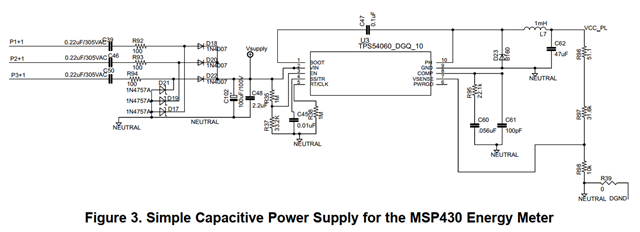

Present  I design LMR16006 with Capacitive Power Supply 1 phase, and have Output 50mA, 3.6V.
if I re design to 3 phase, Capacitive Power Supply , similar SLAA577G does the output current will be 3 times? (150mA)  Do you have any calculatoion formula or applcaiton note how to caluclate ?
  • Hi
    For rough estimation, you can consider it's current source to provide input power as the capacitor impedance is very high
    For one capacitor, the Iin_rms=U_rms / Zc, the average input current after rectification is 0.9*Iin_rms.
    For 3 phase,  the average input current after rectification is 2.34*Iin_rms,
    So power capacity increased: 2.34/0.9=2.6 times.
