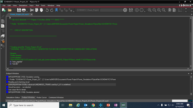

LM62440-Q1: Part Undefined
Part Number: LM62440-Q1
Why am I getting this undefined error for a TI part?

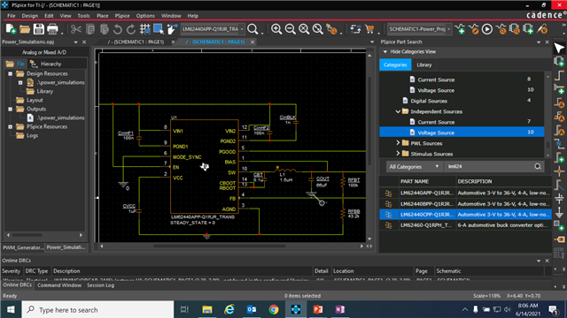

  • Hi Alexander,
    My initial thoughts here is to use the available PSPICE transient model in the device's product folder and change the appropriate components to match your desired schematic. You can test the default PSPSICE transient models to confirm that they are indeed working in the software. On my end I have confirmed that the available model on the web should work and is configurable.
    I am still in the process of checking the issue why adding a new part from the TI library is causing this issue for you. This will require some more information from the internal modeling team who support these software related issues.
    When I get more information on this, I'll let you know.
