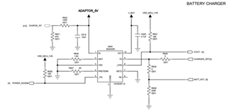

i am using the below circuit for BQ24090.
IN:ADAPTOR_5V
OUT: V_BAT connect to battery parallel with system load.
PG, CHG connect to MCU
TS connect to battery NTC and MCU CHARGE_OFF for recovery.
 BTW, I try to trigger 10-hour safety timer, but not successful even keep EVM continuously charging battery more than 12.5 hours.
Please advise how to trigger 10-hour safety timer.
KPK

    There are multiple scenarios which could be causing the 10 hour safety timer to not trigger. First there is TTDM (termination and timer disable mode), this feature disables the safety timer when the TS pin is pulled high or floated. If your TS connection is accidently floating the 10 hour timer will never trigger.
    The timer can also be increased in real time if the device goes into thermal regulation, IN-DPM (i.e. input voltage fold back), or in usb current limit. For any of these three conditions the timer clock slows by a factor of 2 while in these modes.

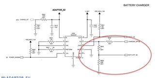

  • hi Garrett,
    Do think think this portion of the circle circuit connection is correct?
    The Charger_OFF pin is controlled by external MCU to pull HIGH/LOW on the TS pin to enable/disable the charging.
    KPK
  • Hello Poh,
    Pulling TS low is ok for disabling the charger, but pulling TS above VTTDM(TS) will disable the safety timer. The MCU should only be able to pull this pin low if you do not want to go into TTDM.
    Can you confirm that charge does not terminate after >20 hours to rule out whether timer is being slowed?
    Nick

    The charging never stop even after >20 hrs. I measured the TS is still 0.5V, this should considered disable charging am I right?
    Can I clarify on the definition of the fixed 10hrs safety timer? does it means under any condition, any charging sequence should stop in 10 hrs?  [Assume without enter TTDM (termination and timer disable mode), this feature disables the safety timer when the TS pin is pulled high or floated. If your TS connection is accidently floating the 10 hour timer will never trigger].
    TS connects to battery NTC via 10kohm to GND and MCU Charger_OFF port.
    MCU port has three conditions:
    1.High-Z : normal
    2.Low:disable charging
    3.High:TTDM mode.
    KPK
  • Hi KPK,
    V-TS=0.5V is in the voltage range for normal operation. Figure 9-4 from the BQ24090 data sheet shows device behavior across the whole V-TS range.
    The device has two safety timers one for the precharge phase which is set for 30 minutes, then once the battery voltage crosses the LOWV threshold (2.5 V) the fast charge phase begins and the 10 hour safety timer is started. During charging the timer may be slowed down as mentioned in the thread above or be reset three ways. These are disabling the IC, cycling input power, or going in and out of TTDM.
    Yes, if your TS connection is accidently floating or constantly pulled high (above 1.6V) the 10 hour safety timer is held in reset and will never trigger.
    Also your battery's NTC should be connected to TS and directly to ground without the additional 10k resistor you mention.
    Garrett
