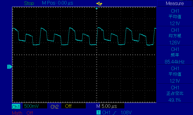

  • I feel sorry for the long waiting. during these days, we optimize the layout and also purchase a current probe to help us analysis. so we get some waveforms, we do change some parameters due to the waveforms.
    with the current probe, we get the important waveform of the inductor. showing as following.
    All the waveform is for the inductor current. div: 1A/100mV
    I do experiment on this status: Vin = 9V , Vout = 12V
    Problems happen with two conditions:1. heavy load 2. Boost Mode
    Some of abnormal waveform is shown as below, I can't resolve that what is happening.
    the second waveform is operating at 12V12A output. It seems that closed-loop control oscillation exists. Because of the oscillation , the circuit can't operate up to 15A (which is my expection).
    If I reduce the load to about 8A. The inductor current waveform is shown as below
    due to the waveform cycle by cycle , the control loop looks not stable enough, but it operates normally at least.
    Until Now , I use parameter as following:
    Cslope = 100pF (C215)
    Rc1 = 2.7kΩ (R206)
    Cc1 = 12nF (C212)
    Cc2 = Remove (C213)
    I have two questions:
    1. How does the oscillation happen. I wonder the reason.
    2. Would you Help me optimize the control loop parameter. Directions for adjustment would also be welcome.
  • Hello Xinhao,
    Please check out your parameters with this quick design calculator from LM5176. https://www.ti.com/lit/zip/snvc208
    These 2 devices are very similar and therefore the calculator should be able to give you a hint in which direction you need to go with the compensation. In general increasing CC1 makes the system more stable as it reduces the crossover frequency.
    Brigitte
  • I found the problem has a little relationship with the current sense filter network.
    I used two 100Ω and 47pF to construct the network which the parameters are recommended by the datasheet.
    I tried to reduce the resistor, then the waveform looks better, but problems are not resolved.
    Is there any suggestion about the filter network according to my operating scenario? (Vin = 9~14V Vout = 12V15A fsw = 340kHz)
  • I can make the circuit stable at boost mode now.
    But there is a new issue.
    the strict operation region seems to be the (Vin ≈ Vout )
    With heavy load , when the input is 12V , the waveform of inductor current is like this
    according to the datasheet, I have reduce the Cslope (120pF->68pF) to improve the noise immunity in the transition region, but it doesn't work.
    Is this issue always happened to this IC? Is there any common solution?
  • Hello Xinhao,
    You should not reduce the filter resistors too much as then destortion of the sense signal might occur. Is the filter placed very close to the IC and are the lines to the sense resistor layed out differentially?
    The problems you are observing seem to be noise injection into the regulation. Please try to increase the filter capacitor on the sense lines to 100pF and keep the resistors as you have them now (which value?).
    In addition, you can reduce the SLOPE capacitor to even lower values, but this reduces as well the current capability of the converter at high duty cycles, so you need to check if the current capability.
    Another idea would be to check if you can increase the sense resistor somewhat to increase the noise immunity of the sense signal.
    Brigitte
