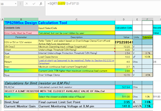

  • Hi Kunal,
    Thnaks for the reply.
    However, customer wants to estimate the max, min value for their choice.
    Customer want to confirm 2 things in TPS2595xx design calculator.
    1. For the row 38, Ilimit_final  Final current Limit Set Point, what does "Tolerance" mean?
    2. In Tolerance cell, what does 0.075 mean in the formula?
    Thanks.
    Jo
  • Hi Jo,
    1. Tolerance means variation in current limit. For eg it is 7.6% in figure so ILIM will vary from 3.95-7.6% to 3.95+7.6%
    2. 0.075 is average variation of current limit due to device which is also mentioned in datasheet . In tolerance cell we are taking two sources of variation ,one is device and other is RILIM resisitor.
