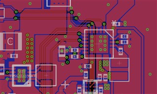

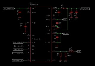

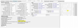

BQ25619E: Vsys ringing when VBUS connect/disconnect event
Part Number: BQ25619E
Other Parts Discussed in Thread: BQ24259,
Hello, I have problem with bq25619E I used is as more available replacement of bq24259 which works great with same board and topology. When VBUS is connected or disconnected I have MCU reset on brown out. BQ registers as per screen. VSYS in on scope enclosed during disconnection of VBUS. PCB layout and schematic enclosed. Any ideas what is wrong will be welcome.
Thank you, Jiri.
