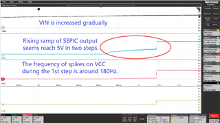

When input voltage is turned on directly, all the power rails seems fine, the system can work normally. But when the input voltage increased gradually from 0V to 5V, it is found that it takes VCC about 1 second to slowly climb to around 2V and then go up to 5V. When VCC is around 2V, there is fluctuation on 3.3V and 1.5V, which potentially breaks the sequence requirement of 3.3V and 1.5V. As a result, the system can't work normally.

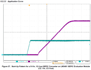

We tested LM3481 SEPIC EVM board, connect its VOUT to VCC in our system. When we increased the input voltage from 0V to 5V gradually, we found its output rising ramp was quite stable and there was no problem on 3.3V and 1.5V either.

Below is the measurement of input voltage (VIN), VCC, 3V3 and 1V5 when VIN is increased gradually.
Below is a start-up waveform from LM3481 datasheet. We found when LM3481 SEPIC EVM is connected with our system, VCC has a very clean rising ramp (similar to the picture below).

    Thanks for your reply. I tried to add a ceramic capacitor beside C30, which is very close to the output of SEPIC circuit. The problem is still there. The graph below shows the powering up waveform after the ceramic capacitor is added close to output. I am trying to figure out why the output of SEPIC (VCC) rises in two step.
    What I want to achieve is that VCC can rise linearly (almost) from 0V to 5V when VIN is increased gradually. just like the EVM board.
    The situation is much better when VIN is simply turned on (not increase its voltage gradually). The graph below shows the powering up waveform when VIN is turned on.
    In addition, in layout the feedback divider is closer to LM3481 rather than output capacitor. The screen snapshot below shows the layout of this section.

  • Hi Brigitte,
    Thanks for your reply and suggestion. For various reason, we chose to use two discrete inductors in our design. It seems quite difficult for us to test a coupled windings of transformer on our board (I suspect if wiring a transformer to the pads on the board will bring more noise). According to LM3481 datasheet, the benefit of coupled winding transformer is lower input ripple and component size.
    For other two parts you mentioned in your reply. I removed D16. I also increased C24 to 2uF (1uF//1uF) and 4.2uF (1uF//1uF//2.2uF) respectively, but it seems the changes have little impact on the power rail and switching signals. I have included some waveforms below when C24 is 4.2uF and D16 is removed.
    The graph below is measured when VIN is increased gradually. It shows the switching signal (SEPIC DR, CH4 in the graph blow) is quite different when SEPIC output (VCC) is slowly climbing.
    The above graph is zoomed in, it shows that when VCC is slow climbing, there are some burst in switching signal. I further checked these bursts in detail, the switching frequency is around 479kHz as design expectation.
    It seems LM3481 tries to work during this period but is not in full work mode. It enters full work mode sometime later, and VCC jumps to 5V very quickly. I don't know what is the trigger for LM3481 to enter full work mode. The resistor divider on UVLO is designed to make sure when the voltage on UVLO is 1.43V, the VIN is 4.23V. LM3481 can work from 2.97V to 48V. So, I think in our design, when UVLO is activated, the voltage on VIN should be enough for LM3481 to work. There must be some other reasons which make switching output of LM3481 not continuous.
    The last graph below shows the waveform when VIN is turned on (NOT voltage increased gradually). It seems the switching signal from LM3481 has a continuous output from the beginning.

  • Hi Brigitte,
    In our design, there is a 0.47uF ceramic capacitor (C33) at VIN pin. Between this C33 and 100uF aluminium capacitor (C36) there is a 20 Ohm resistor (R5). I tried to add some other lower value decoupling capacitors on both sides of R5 without obvious improvement.
    However, I am enlightened by you previous suggestion that VIN and voltage at UVLO may drop when LM3481 begins to work because of the sudden increase in load current.
    In fact, between the power input connector of our product and input power of LM3481 (VRAW_1 in schematics), there is a Schottky diode used as reverse protection. I removed that diode and shorted its two pads. The problem on LM3481 output disappeared, the voltage could rise to 5V straight away even when input voltage was increased gradually.
    My understanding is the sudden increase in load current during start-up increases the voltage drop across that Schottky diode. When input power is just turned on (fast), it will not have much impact on output because voltage increase at input power is fast. When voltage of input power is increased gradually, it just prolong the time when LM3481 struggles to turn on thoroughly, which leads to that weird rising ramp of VCC.
