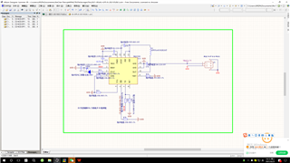

BQ25300: REGN PIN no output
Part Number: BQ25300
I used bq25300 as battery charge IC, but when we power with vbus as 6.8V, the REGN output 0.28V. It is abnormal cause the ic can not work。
We can satisfy the power on conditions of REGN
1. Vbus> Vbat+Vsleep   Vbat=3.6V
2. POL floating, En pull down to GND
sch as attachment
