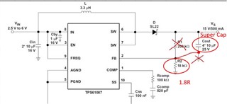

TPS61087: Use constant current to modify TPS61087 FB connect way
Part Number: TPS61087
Other Parts Discussed in Thread: TIDA-050033
Hi team,
My customer uses TPS61087 to charge a super cap. Can I use the below circuit to modify FB connect way?
and use MCU to detect Vo rising to 14.4V that MCU will turn of  TPS61087.
Vin5V
Vo14.4V
Io=0.7A
