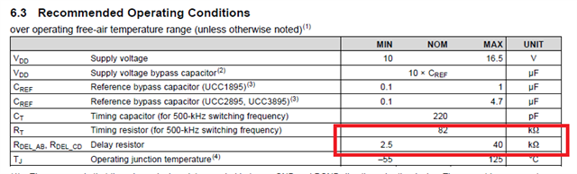

I would like to ask you about the RDEL settings for the UCC3895.
When I designed it before, the data sheet I referred to didn't mention the recommended range of RDEL.
Therefore, the current board has a 510Ω resistor mounted on RDEL.
If a resistor outside the recommended range is mounted, is there a problem in operation?
Please tell me the possible problems.
    The resistor value you have selected is outside the recommended/characterized range.
    The turnon delay most likely will not match the equations presented in the data sheet.
    You should evaluate your design just to see if you can a resistor in the recommended range.

    If you are using a resistor outside of the recommend range the equations that are presented in the data sheet for calculating adaptive delay are not accurate.  We recommend that you use a resistor that is recommended in the data sheet.
    1.  The phase shift and delays will change with loading if you are using adaptive delay.
    2.   When it comes to using a resistor outside the range it is unpredictable what the delay times may be.  You may want to check the devices that you have to see if the delay times match the calculations when resistors in the recommended range are being used.  The UCC2895 dead time is not guaranteed when the resistors are used out of the recommended range.

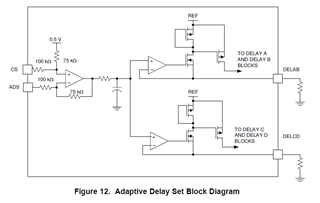

    I did look at  equation 3 and with a VDEL of 0V and a 510 ohm resistor your delay time would be 37.8 ns.  With a VDEL of 2V it would be even less.  This seems pretty fast half the resonant period.  Are you shore you need this time?  I would double check your delay settings vs the switch node to confirm this actually what you need for your design.
  • My idea about equation(3) is different.
    VDEL should be clamped to a minimum of 0.5V, is my perception correct?
    Besides, if you decrease the value of VDEL, TDELAY should increase.
    Is the previous term of the TDELAY calculation formula 12.8ns when VDEL = 0V?
    Also, when RDEL is 510 ohms and VDEL = 2V, TDELAY = 31.4ns. Is this result correct?
  • Hello.
    I reviewed the block diagram and VDEL will be a minimum of 0.5 V as you stated.
    This being the case my calculation was off 0.5V.  With this value the delay would be 50.5 ns when CS = 0 V.
    I do get 31.4 ns in the calculation when using 510 ohms and 2V in the calculation.
    So the 510 ohms is outside the recommended values for the RDEL pin.  The turnon delay most likely will not match equation 3.  TI will not guarantee the UCC2895 when the device is outside the recommended values.  However, the device can and still function, it just may not operate as expected.
