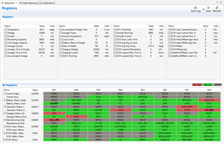

I'm trying to calibrate current measurent on a BQ34110 with BQ Studio, but it seems nothing is happening.
My procedure is as follows:
1) Enable Calibration (CAL_TOGGLE)
2) Apply 988mA load current
3) Calibrate current at BQ Studion, Calibration tab
4) Reset device
Current reading is 981mA and does not calibrates to 988mA.
Additional fact, I had to manually input CC Gain, CC Delta and CC Offset because default values were very different from my application. Now I need to fine tune using BQ Studio and it's not working.
