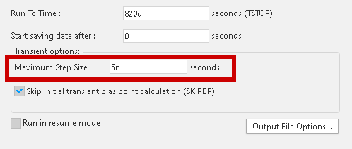

I am working to simulate the TPS543820 model on PSpice for TI. Our customer needs Vin = 4.5~6V, Vout = 1.20V, and Iout = 4.2V. When I try to run the transient simulation, it is taking a very long time to run (after 2 hours, the simulation progress is stuck at 2%). Are there any suggestions to speed up this time, even if we compromise accuracy.
