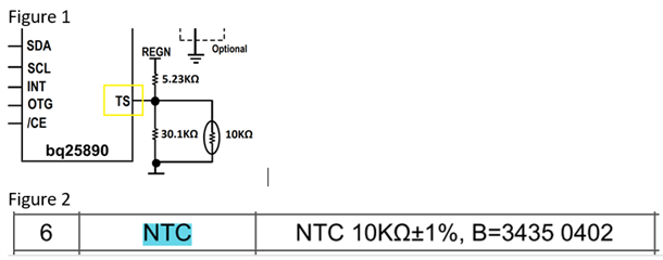

Our custumer have a case of using BQ25890,
After reading the value of TS (as shown in Figure 1), how do I convert it into a temperature value?
The internal NTC of the battery we use is 10K, B=3435 (Figure 2)
Many Thanks,
Jimmy

Hello Jimmy,
Usually we only recommend one device connect to the thermistor because it can lead to incorrect biasing. If you have an MCU with high input impedance ADC you could sample REGN and TS to estimate the temperature.
I think this link may help you with the thermistor calculations: e2e.ti.com/.../bq25895-rt1-rt2-calculation-question
