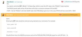

i saw the E2e discussion that Brian did mentioned, to put the PMIC TPS65217 into OFF mode, we need to set bit7 of status reg into OFF (0x1b) mode  and then pull PWR-EN to low.
I tried the command listed but it still doesn't work, i need to turn off the PMIC and disconnect the BAT to SYS. but it seems like even i execute the command above, the BAT is still connected to SYS, which is drawing ~12ma from the battery during sleep.  I tried to cut the trace for SYS, the sleep current drops to ~2mA. Could you help to check how this can be done?

  • Hi Felix,
    Were you able to do a read after writing the following commands, to confirm that OFF bit = 0b?
  • hi Emily,
    I’m using this command to set the OFF bit to 1 : “i2cset -f -y 0 0x24 0x0A 0x80
    To get a read back I used this command : “i2cget -f -y 0 0x24 0x0A
    The 1st i2cget command, I got a read back “0x88”, this is because the AC is connected to the power supply. I removed the power supply to run only on battery, read back “0x80”.
