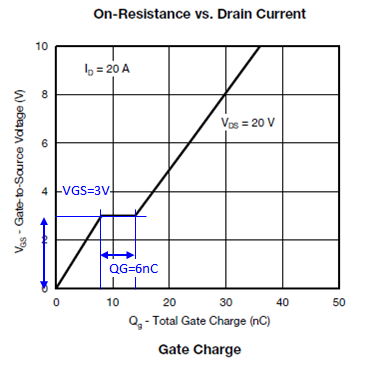

  • Kurimoto-san,
    The Qg of this MOSFET at Vgs = 5V is 20nC.More important for switching times is the Qgd of 6nC.
    More specifically, during the switch voltage transition, the gate voltage of the FET is clamped at the Miller plateau of (~3V for this FET), so there is ~2V of overdrive. This is applied across the effective series gate resistance, where Igate = Cgd*dv/dt = (5V - 3V) / 3.5Ohms = ~0.6A (allowing 0.5Ohms for the gate driver and including the internal Rgate of this FET = 3 Ohms).
    0.6A into 6nC gives a dv/dt of 0.1V/ns, so a typical voltage rise time for a 12V input is approximately 120ns.The result is this is a very slow FET given the high Rgate (should be ~1 Ohms) and the somewhat high Qgd for this Rdson level.
    Tim
  • Hello Tim,
    Let me confirm my understanding.
    Q. Does the 6nC means below?
    Q. Does the 5V means below?
    Q. Does the "Rgate of this FET = 3Ohms" means below?
    Q. Does the "0.5Ohms for the gate driver" means below? In my calculation, should it be 0.08V/100mA=0.8Ohms?
    Q. For the turn on time calculation, My understanding is Q=it, t=Q/i=6nC/{(5V-3V)/3.5Ω} = 10.5ns. I think 120ns is too slow. Is my calculation correct?
    Q. It would be helpful if you can explain why 12V conversion is needed
    Yuta Kurimoto
  • Kurimoto-san,
    Your calculations look correct as I made an error in the last step. These are the calculations for the voltage transition time. There is also a current slew rate related to the transconductance of the FET (the current transition time is typically less than the voltage transition time).
