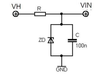

Dear experts,
Because my input voltage maybe exceed over 100V, I want to use linear regulator to limit input voltage in LM5170.
I need to know vin pin current to design resistor and power dissipation.
Zener diode is used to 85V.
thank you
BR
Steven
  • Hi Steven,
    Thank you using the Lm5170.  The total current into the VIN pin is less than 375uA + the current draw by the RAMP circuits, which are two RC circuits discharged each switching cycle.
    Since you input is >100V, just protecting the VIN pin is not enough,  because the SW as well as HO and HB may also exceed their max rating.  You will have to use external half-bridge drivers of >100V rating.
