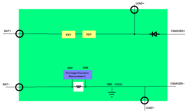

    I made another test. I connected BAT+, CAP1, BAT-, GND and current sens resistors, all simulated battery cells (a series of resistor divider. Previous time all cells were open. I don't know open cells can cause a damage or not?!) , and pull-downed RST_SHUT. I kept everything else unconnected and open, even REGIN and BREG. This time I got REG=1.8V correctly with BAT+ = 20V, I got 30V on CAP1 charge-pump. Tomorrow I will carefully check BREG voltage and my transistor, and if everything is correct, connect REGIN and BREG. I hope everything goes well. I guess I first need to enable BREG with host u-controller and then write OTP.
    Regarding the GND, thank you to point this as I have ambiguity there: on positive line, I have BAT+ on one side, and LOAD+/Charger+ (PACK+ is an alternative naming?) on another side, where FETs are there. On negative side, I have BAT- on one side, and LOAD-/Charger- (PACK-?) on another side, where only current sens is in between (then SRP->BAT-, SRN->LOAD-). referring the TI reference designs, I was a bit confused to where should I connect digital GND (VSS in TI), to BAT- or PACK-. There are net-ties on TI ref. design to connect VSS to both BAT- and PGND(PACK-).
    In picture I try to show my configuration. Did I miss anything?

  • Hi Hamzeh,
    Glad to hear you were able to get REG18 working. For REGIN and BREG testing, I found BREG to be about 6V and REGIN to be about 5.59V through my working range (I'm limited to a 30V power supply), so hopefully this what you will find. If you start to see these values increasing, reduce your BAT voltage and re-examine your circuit before proceeding. I hope you won't have another burnt chip. Additionally, while you're testing, I'd suggest against setting the OTP for REG0 (OTP has limited writes) and continue to just set the REG0_EN with your microcontroller.
    Thank you for the diagram. That cleared up my confusion. However, yes, unfortunately the TI ref is not too clear with the way they name PGND. VSS  should be connected through NET TIE 1 to BAT- , but not connected to PACK- (in your case Load-/charger-).
    So based on your diagram, VSS should be moved to the BAT- side with a recommended net tie.
    Hope your tests continue to go well.
