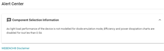

           and another question is how should i resolve the whisper problem in light load, and during the course of simulation i find the following warining
        is this chip have some problem when the light is less than 0.5A?
  • Hi Shi,
    That's just a generic disclaimer as WEBENCH does not provide calculations for operation in DCM.
