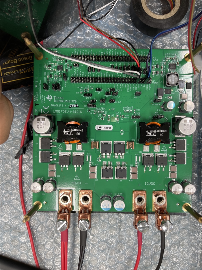

I've close  J2 J3 J4  J21(2,3) J25 J34 J35 J37 J36 and OPT(1,2),
48VDC-Port connect to Fuel Cell 12VDC-Port connect to Super capacitor
I send 5volt to J17-pin5 and a swich to DIR to control buck and boost mode. ISETA send 0.1volt, at buck mode can control the current output around 4-5A,
but at boost mode the the current output is 0.003A.
Where did I do wrong?
