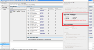

we have used UCD90160A power sequencer in our board. we have used FPWM2/GPIO6 pin to enable the one of the regulator which requires active low enable (by default should be high kept regulator off and should go low while enabling the regulator based on sequence). when i tried to configure this in fusion digital power designer tool seting the pin to active low, its shows me a note as : FPWM pins are driven low out of reset as shown below
later i understand that FPWM pins are driven low upon the reset.  My queries are;

    We do not recommend using FPWM for active LOW ENABLE since the power supply may be enabled when the device is under reset and initialization which takes about ~20ms to complete. Except the POR and Hard reset, there is a also  soft reset which is triggered by the PMBus command.
    It is better to change the design to have it fixed.

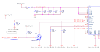

    FYI, the power supply IC is TI's LMZ31710RVQT. we are using inhabit function (INH pin) to control the regulator. we ae using the MOSFET to control the INH. The INH control is as shown below.
    The MOSFET is N channel enhancement type. we have a pullup on gate of MOSFET. so initially MOSFET will be turned on connecting INH to ground so regulator will be off. UCD_ZU1_VCC_1V2_EN_N is the active low enable signal coming from UCD FPWM/GPIO pin. so initially UCD_ZU1_VCC_1V2_EN_N will be high keeping regulator off. Based on sequence UCD will enable regulator by making UCD_ZU1_VCC_1V2_EN_N low.
    Any words on this from you?
    Also our system doesnot issue SOFT_RESET command.
    Thanks in Advance,
    Kiran
  • Hi
    When UCD is under reset and initialization, the UCD_ZU1_VCC_1V2_EN is low to turn on the MOSFET. is there way to change the ENABEL to ACTIVE HIGH so the UCD does not bother?
