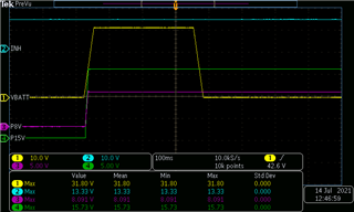

I am using LM51551 in my project application. Please find the schematic below. When I am applying VBATT=20V at 1V/30ms, I see that the outputs are discontinuous as shown. I have connected 80mA load at P8V output and 430mA load at P15V. Why is this behavior observed?

    Thanks for your reply
    Vin = 20V, Vout = 8V and 15V
    Yes there is no such behavior observed in case of no load.
    As you see in the below image, VBATT is the input voltage VIN which is 32V and the outputs are stable at 8V and 15V.

  • Hello Anne,
    The load on the regulated output defines the device mode. The other output cannot be seen by LM51551. As you are regulating the 8V output, only 80mA load are to be regulated which means Power save mode.
    You should regulate the 15V output instead.
