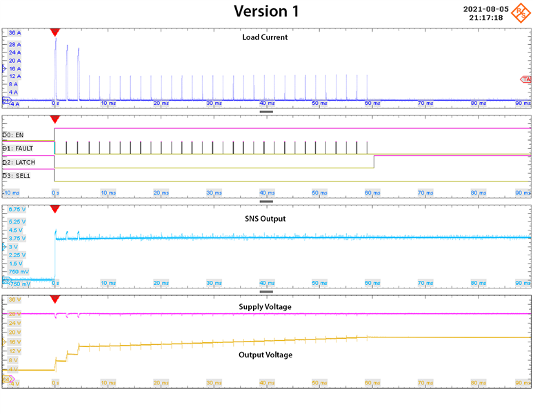

  • Hi Shreyas,
    here are some pictures of what's going on. The load is an DC/AC Inverter (24VDC to 230VAC) with a very high inrush current. All surrounding conditions are pretty much identical (as far as it is controlable ;-))
    Thank you and regards
    Bernd

  • Hi Bernd,
    From what I am seeing this looks to be a repeated current limit fault as evidenced by the foldback.
    The mechanism of current limit in this device is that once the device recognizes the fault, it modulates its resistance to hold current at the defined level. This results in large power losses across the device which eventually lead to device shutdown from thermal protection. For the thermal fault to clear, the junction temperature has to drop below the shutdown temperature by a defined t_hyst (hysteresis). Until this condition is met, the fault state on the device does not clear.
    Good thermal connection between the thermal pad (VBB pad) and the board is essential here. The major heatsinking pathway of the device is to the board through this pad. If there is incomplete solder here then the junction could take longer to cool down that what is expected. From your testing, you can see that the device is recognizing the fault but is not restarting after a long time. I think this points to a slower dissipation of the thermal energy. As mentioned, a good test is to take one of these device from Version 2 board and put it on the Version 1 board. This will confirm if the device itself is exhibiting a incorrect behavior or if the issue lies with the heatsinking capabilities of the board. Another option is to do this test using an EVM which you can acquire from our website.

  • Hi Bernd,
    With the information at hand, both can be acceptable behavior. From what I am seeing, the device correctly turns on, recognizes the CL, tries to current limit, heats up and then shuts down. Once the temperature of the junction has dropped, the device retrys. After unsuccessful retrys, the device folds back the current limit as expected.
    Before desoldering the device, I would recommend retesting Version 1 and Version 2 but set up the device to measure junction temperature.
    The SNS mux internal to the device can be configured to output a voltage corresponding to junction temperature. This may help us understand if the junction is remaining warm for longer time on Version 2.
    Shreyas
