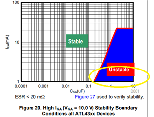

I'm considering an ATL431 with Vka=-10V and I'm looking into the stability regions. On Figure16 it looks like the device is stable with 10uF @ 1mA but Figure 20 then seems to imply this would fall into an instability region. Which is correct?
Am I right in thinking that if I wanted to operate in an instability region that I'd need to add some ESR? If so, do you have a good value for 10uF that would give a good stability margin?

    Figure 16 shows low IKA whereas figure 20 shows high IKA.  If you notice, the Y-axis scale is in (uA) for fig 16 and (mA) in fig 20.  Do you know how much current your setup will be using?
    DId you mean that you want to operate in the stability region, not instability region?  Depending on how much current you are operating with ATL431, you may need to adjust the capacitor value and add ESR for stability of your design.
    Yes that's true but Figure 16 shows 1000uA (1mA) and 2000uA (2mA) but Figure 20 shows 1mA and 2mA as unstable?
    Yes sorry that was a typo - but thank you for confirming. I will test first and add ESR as per the other thread.

    I superimposed the two figures (16 and 20) and I dont see the unstable region that you are inquiring.  Maybe you are referring to the 10uF region for 1-2 mA.  Can you tell where you are seeing the discrepancies?
    Ben
  • Hi Ben,
    Thanks for this. Your graph suggests there are some areas which are stable between 1-2mA. In figure 20, it suggests this region is unstable:
    My application operates at Vka=~10V @ 1-2mA so I'd like to be sure that I have the correct information. It sounds like the best route might just be to test as you suggest and add ESR as required.

    My suggestion is to use the ATL431LI.  The stability of ATL431LI is much better.  Please see below:

    Thanks - I am currently looking at the TL431LI due to availability reasons - it looks like this also has a better stability region but I assume I'll need some additional ESR.
