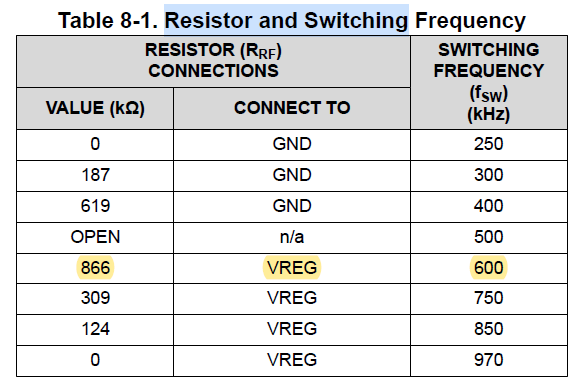

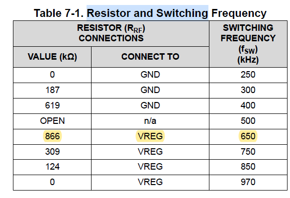

    Thanks for your above comments. Adding one abnormal phenomenon when customer is doing the replacement, which needs your further helps.
    The RRF in customer schematic is 866kohm connected with VREG.  For TPS53319, the tested frequency is around 540kHz, which is in our D/S range. But for TPS53353, the tested frequency is around 550kHz, which is beyond our D/S note range.
    And RRF frequency setup table for TPS53319 and TPS53355 is almost same except for 866kohm. I wonder there is possibility that TPS53353's D/S may have a mistake in 866kohm frequency setting. You may look at below two D/S screenshots for details.
    • TPS53355:
    • TPS53319

  • To be honest, I think both datasheets have mistakes.
    When I test the TPS53319 and TPS53353 evm  with 600/650 setting at a vout of 1.5V (VIN=12V) I get 626kHz and 634kHz respectively.
    So 600 kHz and 650 kHz may not be the ideal numbers to represent the settings.
    There is also a dependency with vout. At vout of 0.6V, with a 600kHz setting, i get 464kHz for the TPS53319.
