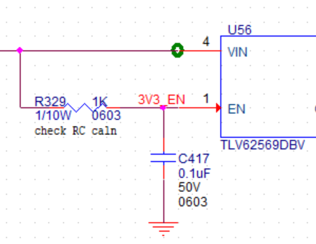

Hi Team,
Can I delay the enable input using RC with VIn at 5V, Vout at 3.3V.
Start up time spec is defined to be 800us typ. what is the max. value?
Please revert.
Vidhya
Hi Vidhya,
Yes it is okay, I do not see any problem in delaying the EN pin with RC. Only important point is that voltage at EN should never exceed the VIN. Regarding your 2nd point, we do not mostly define the max/min value of the softstart time in the datasheet. I have sent you a separate message, we can discuss more there.
