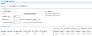

Something seems off on the cell voltage monitoring, when testing the balancing on the EVM, I’ll try to explain my setup and procedure as clear as possible so you can give me some insight.
SET UP
I have connected a battery stack with 6 cells on J1 pins 2 to 8 and left Pin 1 & 9 Unconnected
I have jumper J2 and J3 ON to power the board from the battery
I have the SW2 on the OFF position and the on-board resistor ladder is Unconnected
BQstudio SET UP
I have the following configuration for Cell Voltage monitoring and Balancing
When I enable Balancing without the comparator the CB_RUN is completed
Then I check the Cell voltages during the balancing procedure.
The cell that is “bleeding” current has a voltage drop when measuring, around 0,665 Volts
And the cells that are next to the “bleeding” cells have a voltage rise.
ODDS balancing
EVENS balancing
Also because of the Voltage measurements are like this if I activate the Comparator, it immediately “completes” the balancing,
I guess because CB_DONE_THRESH is triggered and CB_DONE is then set.
