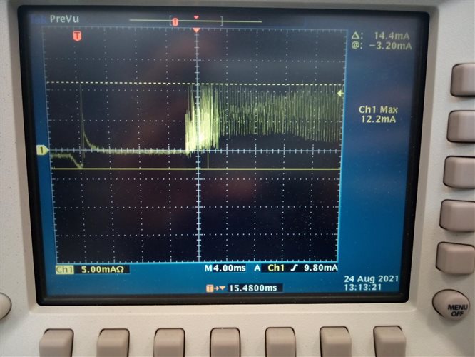

    Attaching the input voltage screenshot and a picture of the input current on startup. The input was 30V.
    Current:
    Voltage:
    Anthony
  • Hi Anthony,
                     The scope shot showing the input current is interesting. Does the ringing die down eventually? I am concerned about the bump at the 4mSec mark (from the left) where the current seems to go negative. This indicates flow of reverse current which could damage the device. Would it be possible to add a diode at the input to prevent the flow of reverse current? Could you verify Method 1 (Schottky Diode) or Method 2 (Diode before LDO) described in the following link: https://e2e.ti.com/blogs_/b/powerhouse/posts/ldo-basics-preventing-reverse-current-in-ldos on a new board and verify if the issue remains? It is interesting that the Input voltage takes around 40mSec to reach the final value, but I don't see anything in it that could cause abnormal behavior. Thanks!
    Srikanth
  • The ringing does not die down eventually (if I am understanding you correctly). I believe what is seen on the right side of the input current is expected operation, as the regulator powers the 12V portion (DVRCC, VCC - Input between -0.3 and 20V) of a NCP1034 PWM Buck Controller. Perhaps the load on the output is causing the issue? I included a zoomed in shot of what is seen on the right. No changes to the voltage seen, and the output current here is consistent with what was seen before the diode as well.
    We added the diode (Method 2, before LDO) and this does indeed eliminate the negative current seen, but the output of the regulator remains the same as before. I used a brand new regulator and installed everything before powering on.
  • Hi Anthony,
                     If the timescale of the Scope shot is 20uSec, it looks like the input current ripple frequency is ~100KHz. Does this match the switching frequency of the Buck regulator? Could you verify if the LDO is functional if the load (Buck controller and any other) is removed? Thanks!
