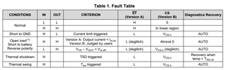

    These two devices are pin to pin compatible, and the feature set should be the same. About the fault condition, they have the same behavior according to the following tables. Please let us know if you have any specific concerns.

    For reverse polarity situation, normally it's recommended to add a blocking diode or ground network for such protection rather than relying on the body diode. If output is shorted to another supply, and the only impedance is from the FET, then the current is likely to exceed 4A as well.
    Please refer to datasheet section 7.3.4.7 for more reverse polarity protection if that's a situation in real application.
