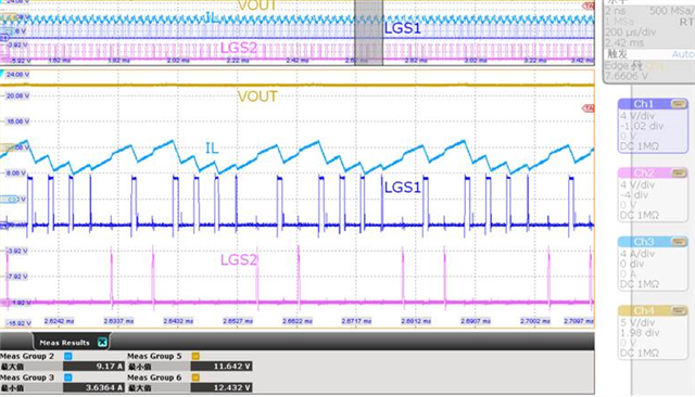

LM5175EVM: gate driver signal not consist
Part Number: LM5175EVM
Hi, team
my customer are testing LM5175EVM, have have questions below. (LGS1: high side, LGS2: low side)
1.VIN=14.3V~15V,VOUT=12V/IO=6A, at transition to BUCK, the output not stable, the waveform shows below

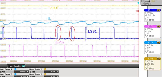

2.VIN=11.3V~11.7V,VOUT=12V/IO=6A, transition mode, low side gate signal shows not consist.

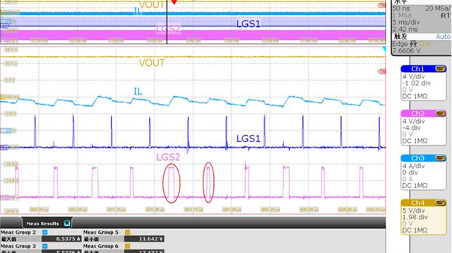

3.VIN=12.4V~12.8V,VOUT=12V/IO=6A, transition, high side gate driver signal shows not consist.
