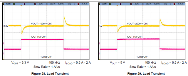

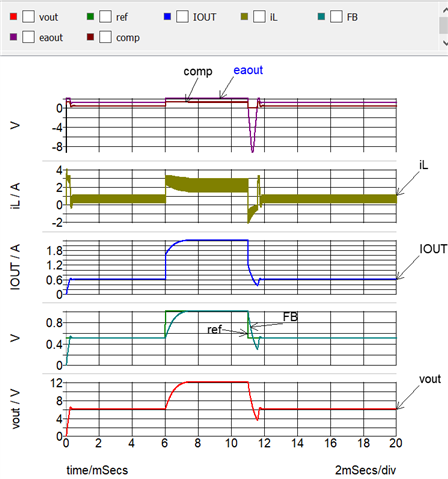

Hi team, I am learning peak current mode. I suggest that the limitation of voltage compensator output would influence the load transient behavior.
And in the datasheet, load transient waveforms are very smooth without reverse over/undershoot.
I guess the min limit of voltage compensator output is around zero, and there would not be large negative values. Because if there is big negative accumulation on the output, it will take a long time to recover, making a second shoot. And the max limit may be decided  by the max peak current.
Or the loop is compensated so well, and second shoot should not happen?
Hope you'll help to clarify this.
