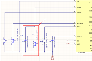

     Currently, LM5176 is used to build a BUCK-BOOST circuit, input 8V~36V output 12V/3A. The first version of the PCB debugging function is normal, input 24V input current 20mA when the output is no-load. The second version of the PCB uses exactly the same components as the first version, but the size of the PCB has been modified, and the layout is different from the first version. When the output is no-load, the input voltage is 24V and the input current is 40mA .The no-load current becomes larger. Similar problems occurred in the first version of the PCB, but the switching frequency was changed from 200KHZ to 400KHZ, and the output switching ripple was reduced and improved. But the second version of the PCB switching frequency is already 400KHZ. The output ripple is obviously reduced by increasing the output capacitance, but the no-load current is not reduced. At present, there is no good way to optimize as desired. Can the no-load current be optimized by modifying the parameters of COMP (see the figure below)? Or there are other ways to optimize this no-load current. thank you very much.

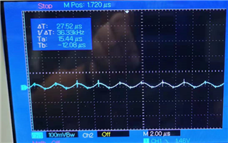

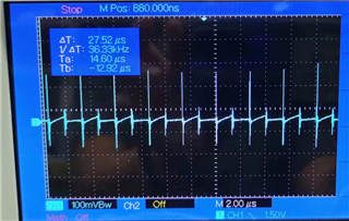

    I measured the waveform of the sampling resistance of the first and second PCB versions (R9 in Figure 1 below). The resistance of the first PCB version does not have a high peak (as shown in Figure 2 below), but the resistance of the second PCB version has a high peak (as shown in Figure 3 below). I suspect that this peak causes the inductance to heat.
    The following spike is the waveform at no-load. Under the same load, the power consumption of the second version power supply is greater than that of the first version power supply. The components of the two are exactly the same, but the PCB is different. I'm confused about what causes the differentiation. I hope you can help me analyze it. thank you!

  • Hello Sheng,
    The spikes are caused by parasitic effects at the moment when the switches turn on and off.
    If both boards have exactly the same external components, the difference in layout causes these spikes.
