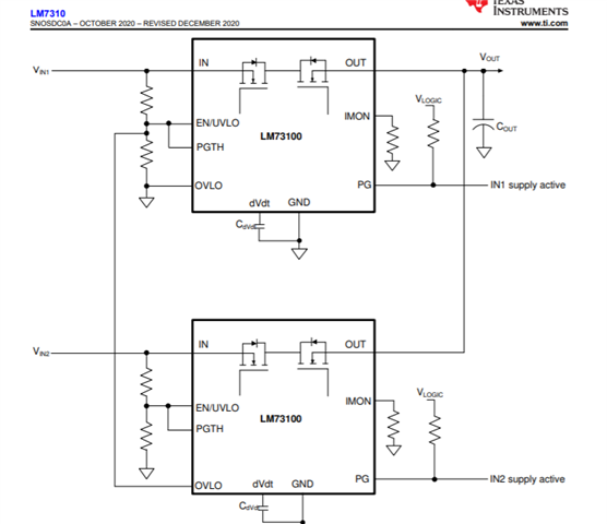

LM7310: Power ORing with priority and OVLO
Part Number: LM7310
I would like to OR 2 power sources (each are 9 to 20V). Both can be present at the same time, or not. In case both power are available, I want to prioritize one power. The datasheet shows a schematic for that purpose but without UVLO function. Is there a simple solution to keep UVLO function, adding only a few discrete devices?
Thank you,
